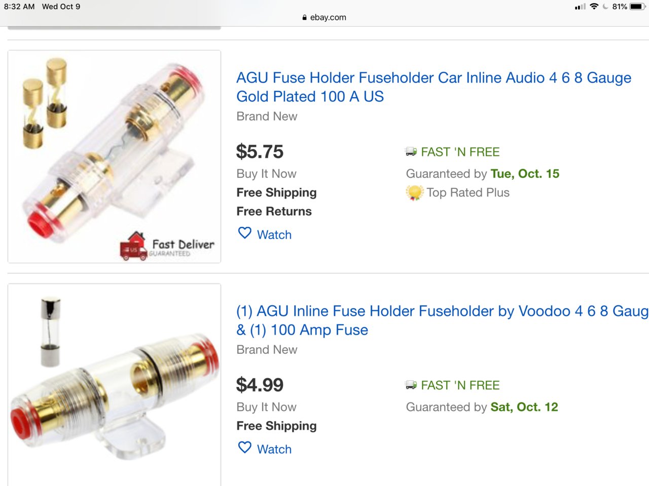

    Ok, so I’m not running any high amp drawing items on my truck.
    So since I’m running a positive power line directly from the alternator to the battery I should have
    an in-line fuse just for safety.
    What amp in-line fuse should I install? 100?
    Can I use any audio type in line fuse?
  5. Oct 9, 2019 at 7:45 AM

    you should get a fuse that is slightly higher than the max output of the alternator, I would assume.
    I'm not a fan of those vial type fuses. They sell high amperage fuses for car audio that are a bit better.
    These mini ANL fuses are the ticket. Or you can go with a full size ANL fuse also.

    If your going to use a fuse I would just use the OE toyota one and swap it out for a 120. The toyota fuse setup is nice and easy to find replacements if needed.

    I have no idea. That's something I have been wondering about as well. Plus, if you have two separate wires generating current to the battery, would you even need to get 4 gauge wire? You might be able to get away with 8 or even 10 gauge. Again, I have no clue about the efficacy of this. I haven't installed my alternator yet. Still sitting in the box :( Too many other projects going on right now.

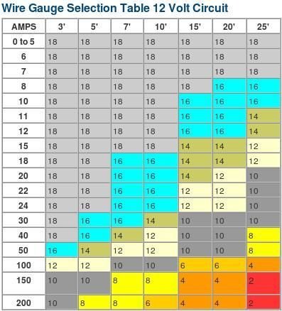

    The fuse is protection for the wire itself so that you don't overload it (i.e. burn the insulation and cause a fire). Use an ampacity chart to determine the current that the wire can handle and go with a fuse that's rated for that current (or smaller). You definitely do not want to use a fuse that has an ampacity greater than the wire. This works for parallel runs as well.
    For example, a 18awg wire that is less than 3' can handle up to 40A. It would be fused at 40A or less.

    You could potentially go with more than 200A per. Again, the fuses are only there to protect the wire. The output of the alternator doesn't matter because the fuses aren't there to protect the alternator. If it makes you feel "safe", you could put 65A or 120A etc on each and risk blowing them. Bottom line, don't exceed the ampacity of the wire.

    If you're curious, for equal length 6 and 8 gauge wires, you should expect to see 61.4% of the current in the 6 gauge and 38.6% of the current in the 8 gauge. For a 105 A alternator, 64.5 and 40.5 amps respectively.

    Yes, it's a larger wire (lower resistance), and it will therefore carry more current. For wires (or any resistors) in parallel, the voltage through all of them is the same, but the current through them is split according to the resistance. The equivalent system resistance is calculated as follows:
    1/REquivalent = 1/R1+ 1/R2 + etc... So you can see the equivalent system resistance is less than any individual wire. To find the ratio of the current that flows in any particular wire, you divide REquivalent by the resistance of the component in question.
