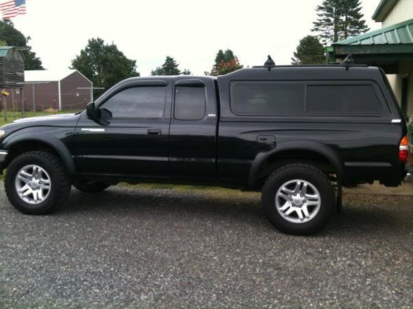

    Hey guys I have a similar problem. I just bought a 2003 Tacoma 4wd and want to lift it.
    I am looking at the Bilstein 5100's in the front and a Add a Leaf in the rear. Is this all I need to lift it? About how much of a lift will I get? Is it easy to install these on my own? And will this set the truck at level, front higher, or rear higher? Thanks guys, I am new to this whole thing haha. Here my truck :)

    :rofl::rofl:how on earth is that a similar problem to a 14" ifs lift? And reviving a 2 year old thread to do it too.
    Wrong section but ill answer your questions because you seem lost.
    5100s in the front and a 2" aal in the back is the starter, decent lift, so yes its a good lift. You should get new shocks all around, so just get the front and back 5100s You will get 2-2.5" of life which is enough to clear 33s with minimal trimming, depending on your back spacing/width of wheel. It is fairly easy to install. The rear is easier than the front. For the front once you get your strut out take the whole strut to a shop to have them put on the new 5100. Auto zone spring compressors suck and are not worth the problem and doing it with a floor jack is dangerous and not advised. It will put the truck pretty much level. If you have any more questions narrow your search to the 1st gen and suspension section and/or ask your question in the 1st gen section with a new thread. Or just pm me, as i also have the 5100 aal lift right now, and put it on myself one night with the laughter and guidance of my bros in the ID/WA bs thread.

    Yeah I accidently had 2 windows open and thought I was viewing a different one.. Realized right after. Thank you for the advice though haha. How much does it cost to have the shop help?

    Some shops won't swap out your own strut with your parts but i guarantee if you call a few places you will find one that will. It's going to be about 20-40 a strut. But trust me...it is worth it to just have them do it.
