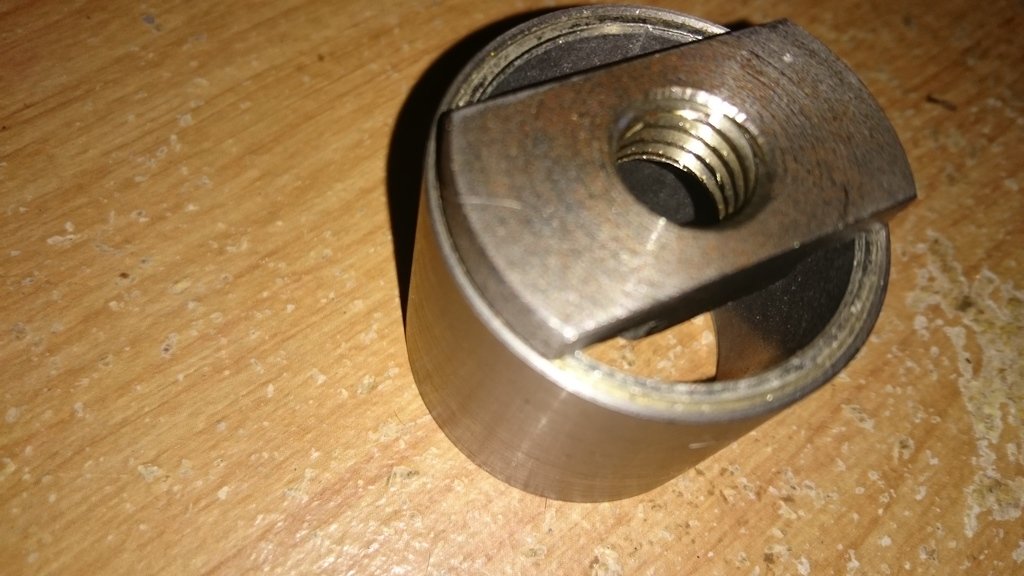

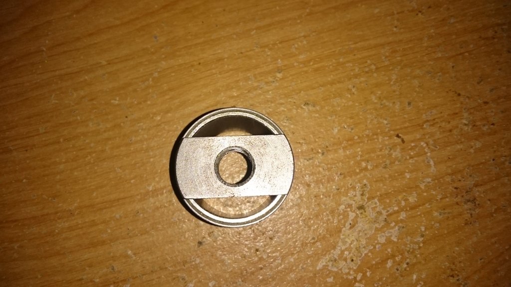

    Should the 7.5 clamshell tool really be ground to work or was that manufacturing problem fixed?

    From what I've read (I bought the tool used and received it ground already), every single one has had to be ground. Maybe checking with ECGS would be best. I don't think they corrected it though.

    Not sure why it would need to be unless its tight installing. The od of tool is smaller od of bushing by a bit.

    It looks like it should work. Check the 2nd page of this thread, a member here (Alderleet) measured the tool and bushing and found the opposite. You can always start the job then if you get stuck, stop and grind the tool.
    Not sure if this has been done. Like I said, I bought mine used and already ground. For those looking to purchase a new one (or those that have already purchased), a call/email to ECGS should get you an answer.

    Manage to get the tool in without grinding it but it was tight and required a few taps. Pulled the bearing out no problem.
