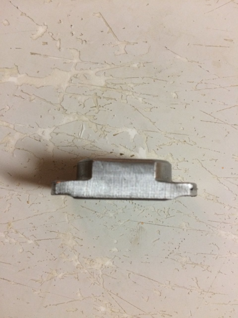

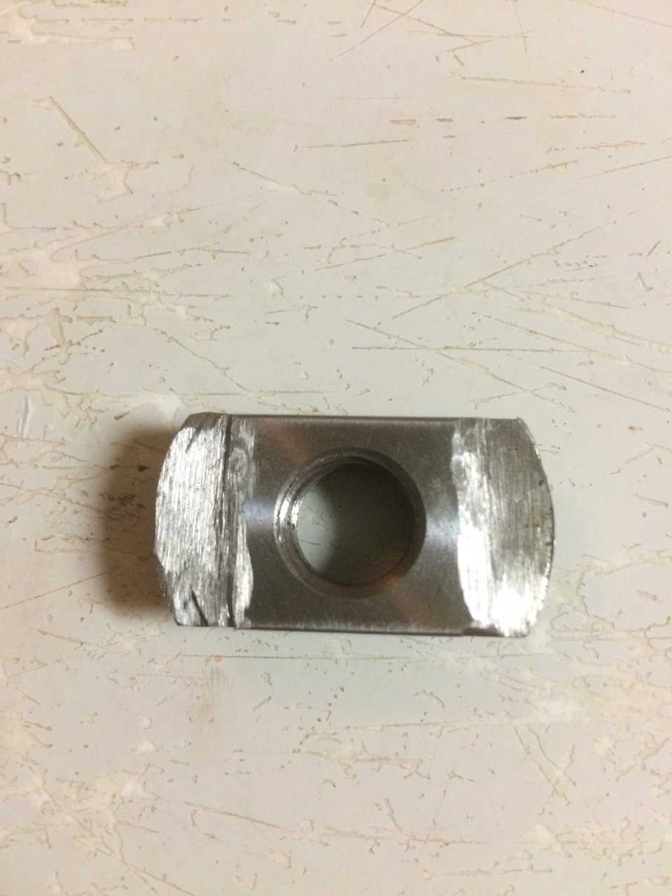

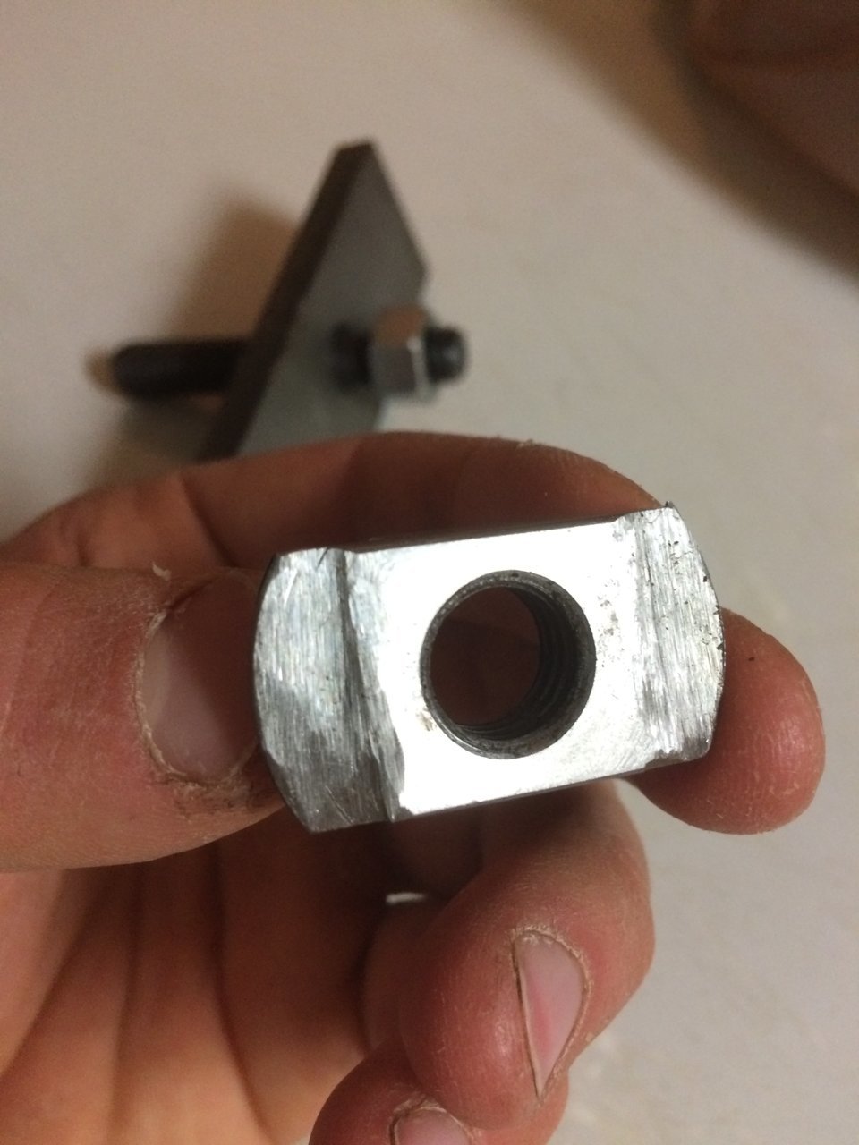

    I have a modified one (flange grinded down) I'm going to post for sale tomorrow night after work! It worked great for me!

    @Bulldogdad and @Burro I just posted the modified ECGS removal tool in the marketplace!

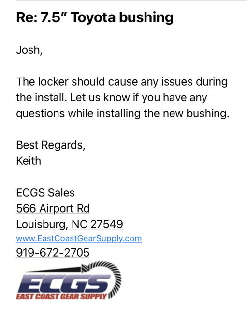

    I searched for and skimmed pages for any reference to the ECGS bushing causing interference with a locker due to it being slightly longer. I’ve got the classic symptoms of a rurnt needle bearing and would like to be one and done with their bushing. I suppose it could be cut down to the length of the bearing.
    Anyone know if it’ll work with a lunchbox style locker?
  10. Dec 13, 2022 at 11:15 AM
    #290
    Brake Weight
    Brake Weight But it hasn't rained in weeks...I'll make it.
    Jan 27, 2015
    #147363
    2,879
    Deep South near the Third Coast
    Taco pulling 33s and a B6 pushing 33psi
    Weld on sliders, fiberglass shell, 12k winch in an Elite Offroad bumper, front Aussie Lunchbox

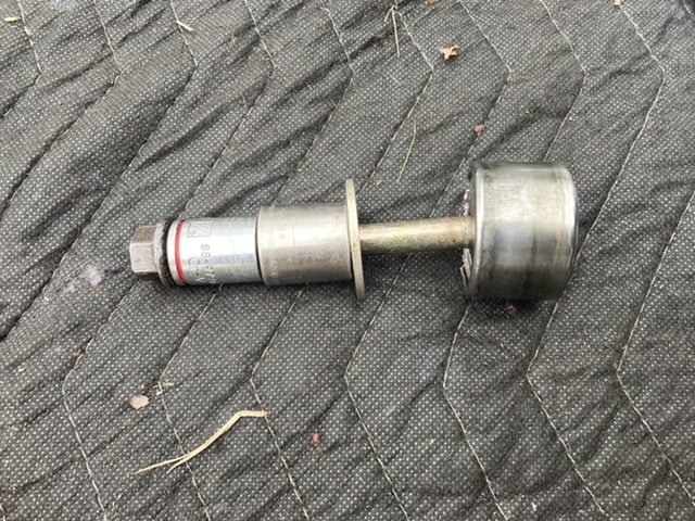

    I emailed ECGS and received a reply. It reads wrong but we know what he meant.

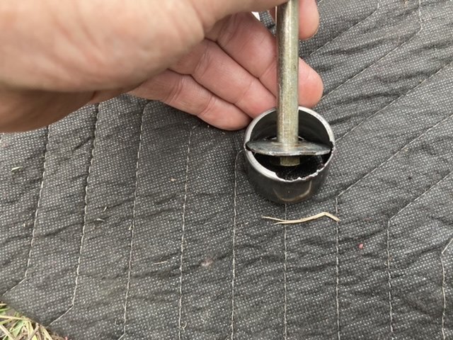

    Having already ordered the bushing I did not prepare myself for the job. I had one of those junky axle bushing pullers that’s similar style to what ECGS sells (that I didn’t order). Bushing shows up and my axle pullers are useless. I have a set of those birds beak spud bar type sets from harbor fright and the medium one worked for a 1/4” or so by prizing from the back. In frustration I removed all the bearing and proceeded to smash it with a sharpened chisel and punch. After cracking some of the face off I realized I could possibly slip a large washer into the empty race. I did and it worked using a long bolt and pried it off with my ball joint pickle fork. The mechanic gods smiled in my favor today. Beat the bushing in using my 2# shop hammer as dead weight and swinging my 8# hammer against it lightly. Went in straight and took maybe 10 blows to reach depth.
