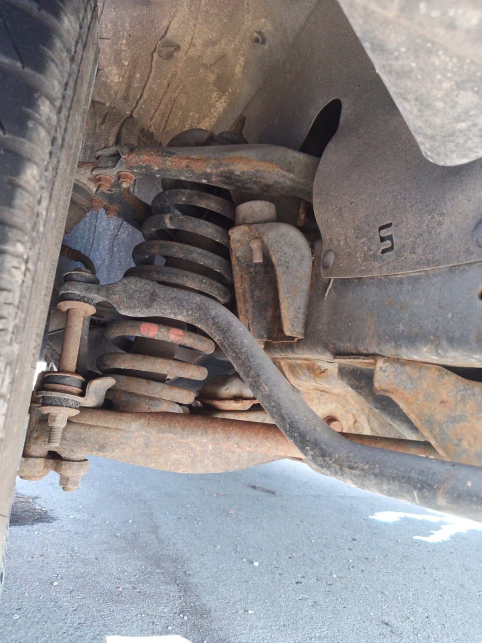

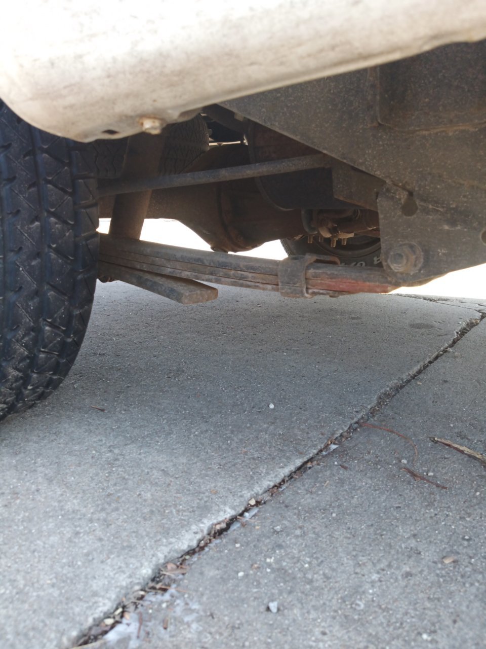

    Alright thanks. My goal is to use it as a work truck rather than lift it. I added some pictures

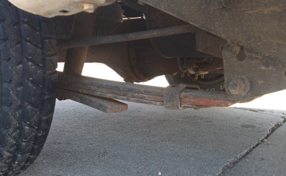

    Those spring don't look flat yet. If u gonna use as a work truck and will have the bed full and heavy alot I'd recommend an aal. It will be stiff as shit tho if u don't have the bed weighed down as an FYI. That or use a shackle lift to get 2 more inches in the rear. That way when ur beds loaded u will sit nearly stock.

    Is that the factory leaf pack? I thought 5 lug only had 2 leaves and the overload at the bottom. Yours have 3?!

    Front coils don't look tired either. Do u want more lift in the front? If not then leave those for now and just get kyb shocks from Amazon 30 bucks a piece. They are great

    Oh shit, yeah I think he already has an aal or new springs ur right I only have 2 and the overload. Well my dude ur trucks already set, buy some wheels and tires and shocks and run it to the ground like every other toyota lol

    If anything, the shocks probably need replaced and check the ball joints, inner tie rods and outer tie rod ends. When I did mine, the outer tie rod ends were still super tight. The inners were toast. The ball joints were just OK. They could have gone longer but certainly didn't hurt anything to replace them.
    Judging by the height, it does look like your springs might not need replacing yet.
