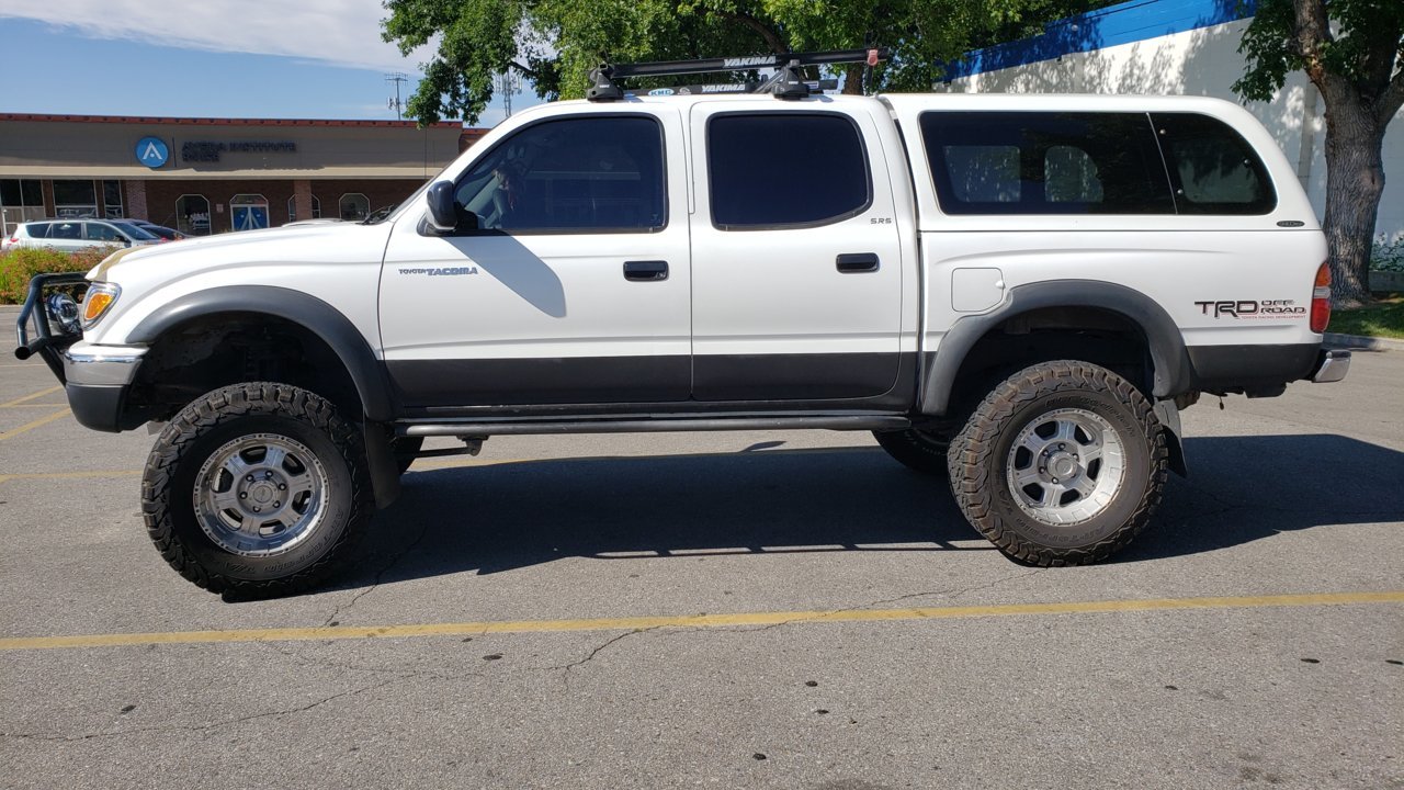

    I know I'm late to the party.. But I'm having the same issue as you with a TERRIBLE ride for a 6inch fabtech lift on 04 Tacoma.
    How did the king shocks replacement workout for you?
    I'm looking for a direct bolt on replacement like you.
    Anything you'd do differently now that it's been a few years?
    Thanks,
    C.

    I am very happy with the Kings and would not do anything different with the front lift. However I installed 6" ALcan rear leaf springs (to eliminate lift blocks) and they are too stiff. This causes my ride to be a bit harsh. I am planning on removing the lower 2 leafs and regain lift with a 1" or so block. I am hoping this gives the rear a softer ride. BTW...lift block up to 2" are OK, beyond that they start to cause issues with axle wrap.

    Interesting good to know.
    I have 3-inch blocks in the rear... looking at doing some progressive springs to eliminate them...
    With the Fabtech front struts and blocks in the rear... the ride is terrible and stiff. (been like this for 10 years)
    I have been looking at the Icons to replace the front. Expensive.. but better than teeth chattering neck-breaking suspension.
    Thanks for your help and nice truck.
