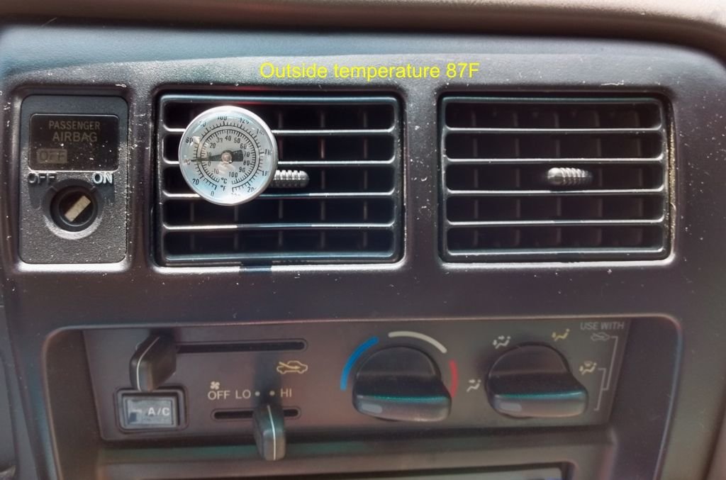

    The UAC kit worked out great. I flushed the evaporator and kept it along with the original expansion valve. Since there was no evidence of shrapnel or particles contaminating the system, I kept the work to "under the hood" components.
    The only complaints so far are from passengers requesting that I turn up the temp from them being too cold. I had to check the temp this afternoon at 1 PM at 87F to see how things are working.

    Was the is idle? With recirculation? In shade or sunlight?
    Mine rarely gets to 40 unless it’s cloudy and I’m cruising. It’s usually around 45 degrees. I think the black paint sucks up a lot of heat too.

    At idle. Recirc was on. Fan next to high setting. In 1 PM CT sunlight 87F. Truck color is gold.

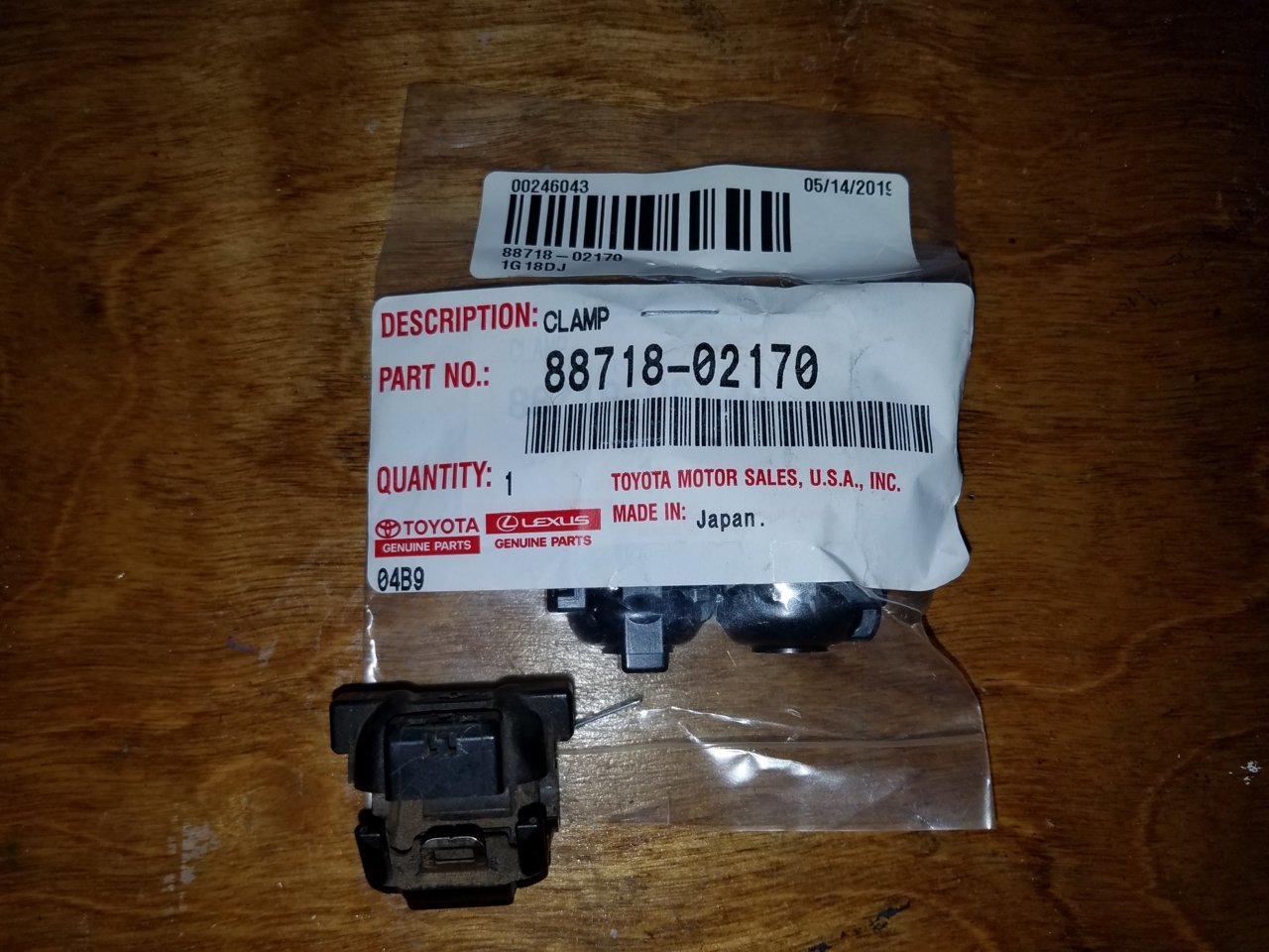

    Got new clamp for line going to evap . In pic can see metal clip holding clamp together and on top 2 holes to access tool to push clip in to release clamp . I used electrical terminl tool to push in clip
    Old clamp was still good but for $7 I just will replace
