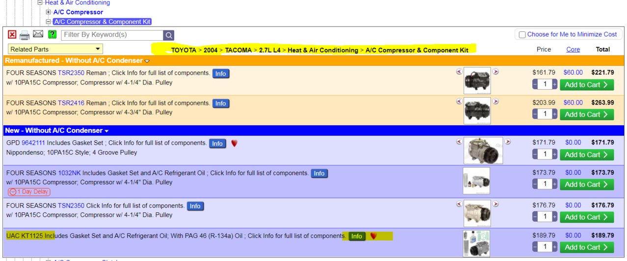

    Nice, I'm unfortunately not seeing a kit under 2004 2.7L

    Here's the kit if you ever need it. 2004 - Tacoma - 2.7 L4 - Heat and Air Conditioning - A/C Compressor & Component Kit.

    Thank you bro lol
    I must have glanced over it a few times, its late and i've had a long day.
