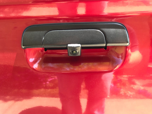

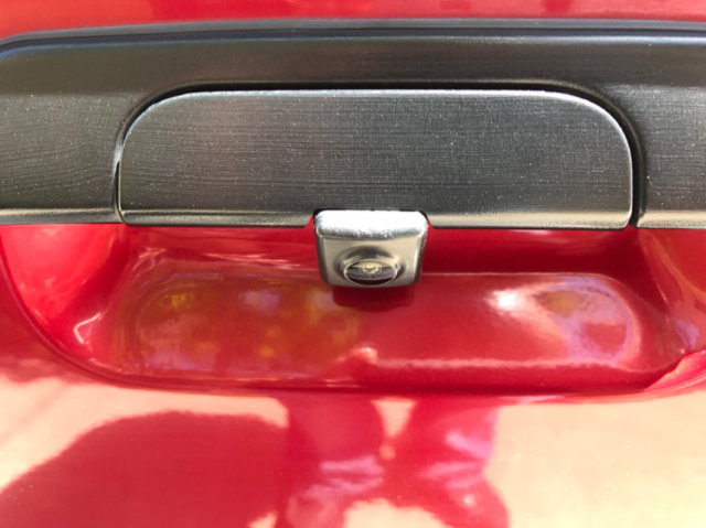

  16. May 2, 2018 at 12:48 PM
    #16
    sirsaechao
    sirsaechao Well-Known Member
    May 29, 2009
    #17772
    3,100
    Tim
    CA
    2002 Toyota Tacoma SR5 TRD 3.4L 4X4 V6
    A lift, some wheels, some tires, some performance, some cosmetic and then audio.
    Here’s my Alpine backup camera fitted on my tail gate handle. The headunit is the 8” Alpine INE-Z928HD and the camera is a Alpine HCE-C117D:
  17. May 2, 2018 at 4:19 PM
    #17
    blubyu90
    blubyu90 Member
    Oct 13, 2017
    #232908
    17
    SLC, UT
    2021 Army Green DCSB M/T Off-Road
    Do you have a write on how you did this? That looks factory!!!! Props to you for a clean install.

  19. May 3, 2018 at 10:17 AM
    #19
    sirsaechao
    May 29, 2009
    #17772
    3,100
    Tim
    CA
    Sorry I do not. It was actually installed by my local car audio installers when I purchased the headunit and the backup camera.
  20. May 3, 2018 at 11:23 PM
    #20
    RysiuM
    RysiuM Well-Known Member
    Oct 18, 2015
    #167004
    2,709
    Rysiu
    Was Golden State, now Poland EU
    1995 4x4 LX Ext Cab, I4 2.7, MT, 335K miles
    DD Deck+backup camera, LED DRL, All LED except H4 Hella
    Do you have a picture what camera is showing?
