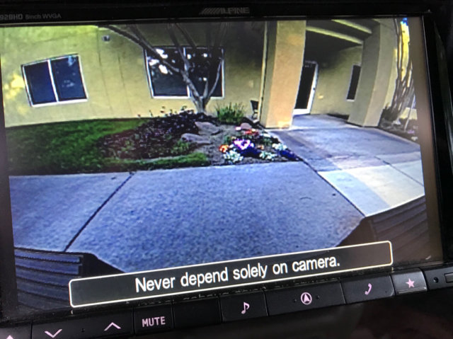

    Just snapped this at 6:55AM

    Thank you. That shows the position of the camera is perfect. If it has more angle it would show both corners. This is what I'm looking for. I tried this position with my esky but its angle is still not good enough. Looking for true 180 degree horizontal camera.

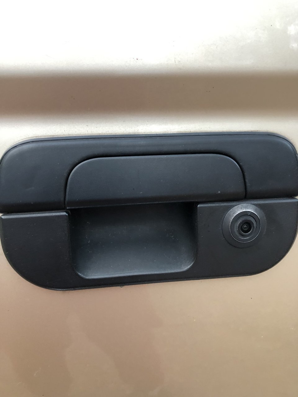

    I was looking into the effect like this one
    #25

    It’s a knockoff of the pop n lock bezel. The casting looks super cheap. Totally pointless, can just buy the camera for $30 and drill a hole in the handle. Or you can use the plate mounted camera which I have.

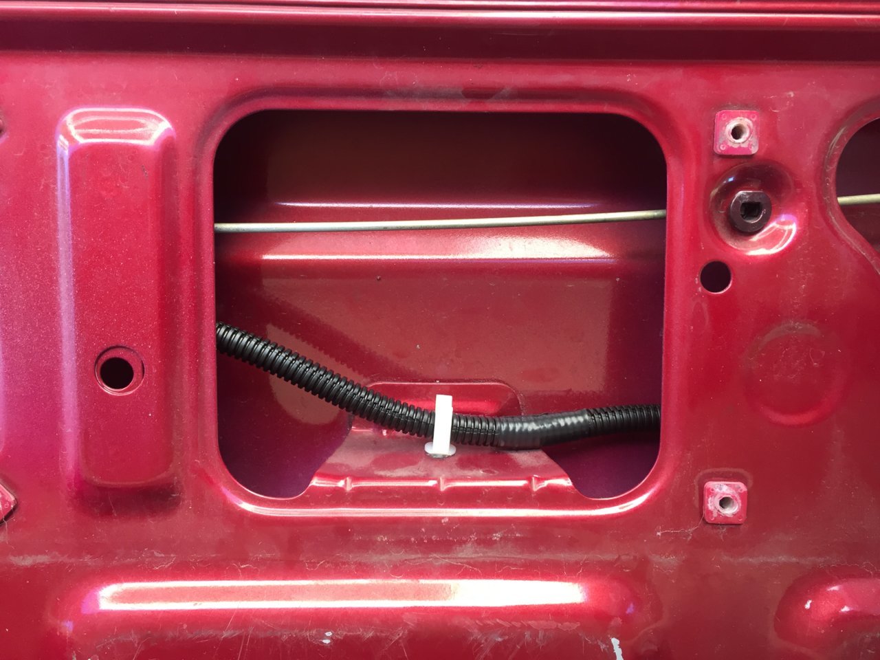

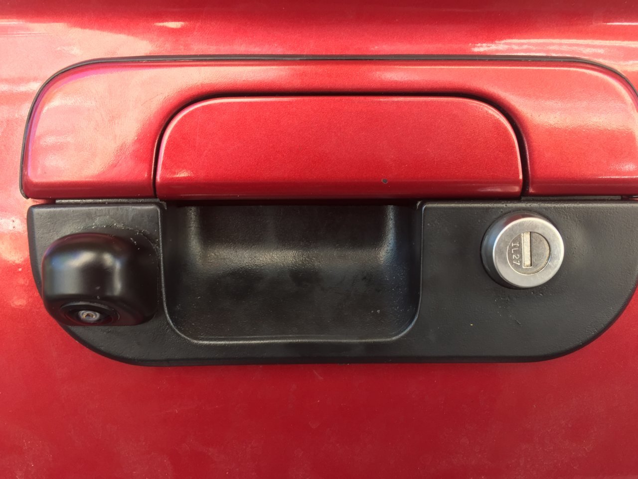

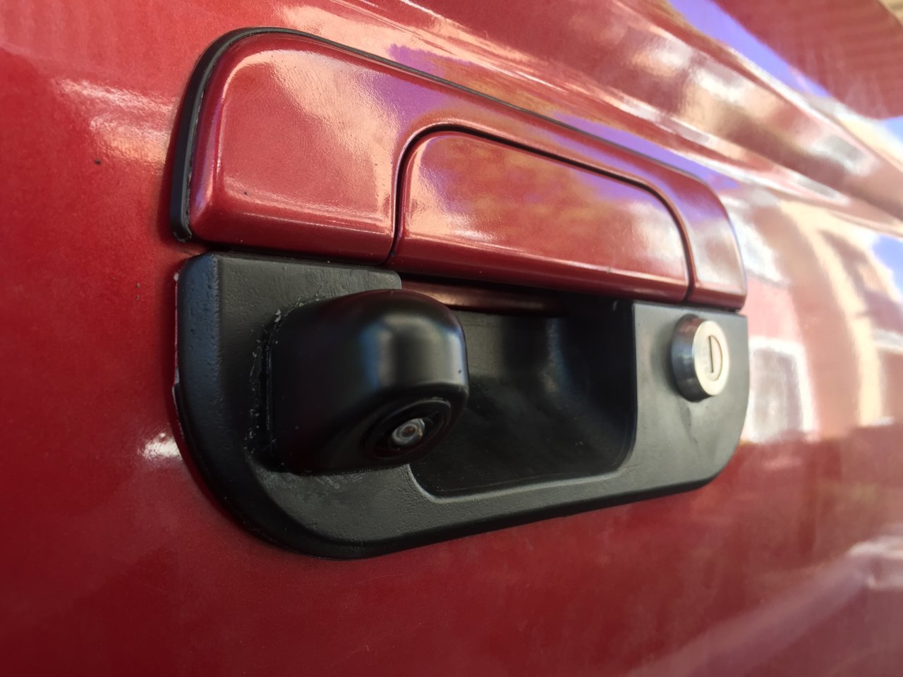

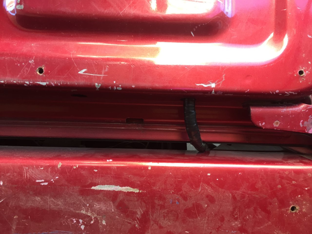

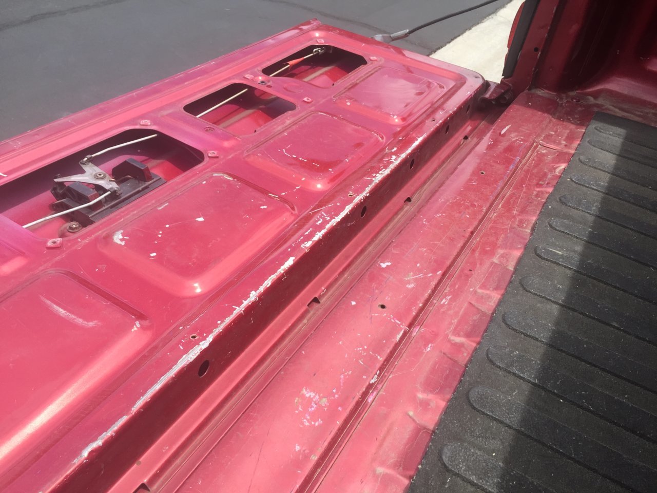

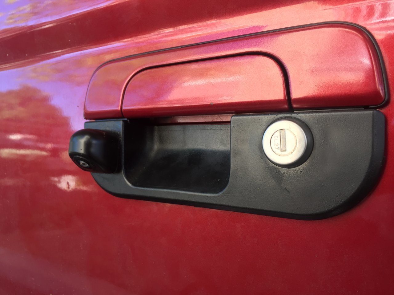

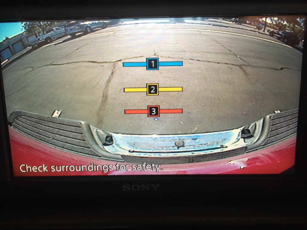

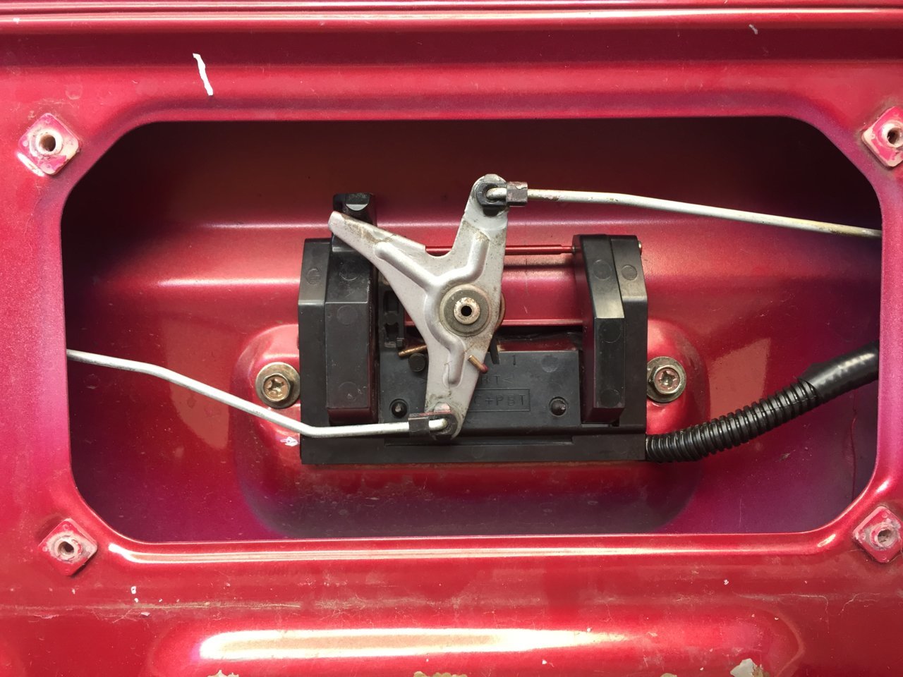

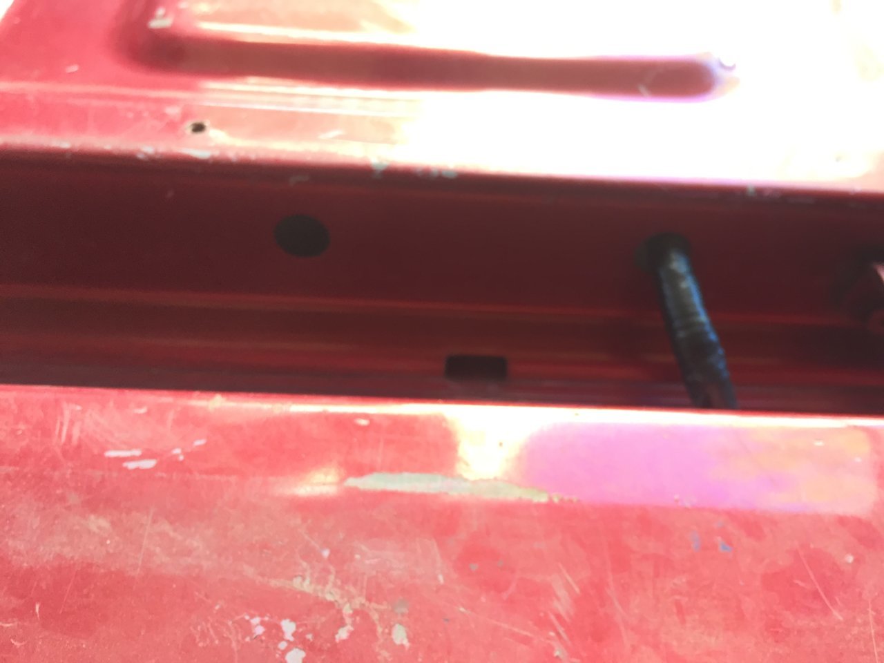

    @Brandons2004tacoma - I literally just finished installing an aftermarket camera onto my tailgate handle. My truck came with a keyed tailgate - no idea the brand. I have any 2001 XtraCab. Photos below. Drilled through the plastic only - OPTIONAL drilling into the tailgate - although I did use a file to widen a natural gap from the steel printing of the gate handle - I'll call it out in the pics. Super easy process. Also, I soldered Female/Male 18-22AWG Blade adapters onto my reverse light's + / - wires, incase I need to change out my light or camera... Once I determined the connections were going to be housed behind the driver tail-light, I decided to come in through the back of the cab (at the driver access box were there jack is kept). *In hind-sight, I might have considered coming in through the standard under-cab waterproof mount (directly under the driver seat, under the cab). The length from the tail-light to the back of the cab, following the OEM wire harness, is 75" - I made my wire harness using the normal plastic wire jacket, followed the OEM brake-light route, and zip-tied it to the same wire track. Once inside the cab, I took off the door-trim panel, by the driver-seat floor, took off the left-forward kick-panel, and took off the bottom panel under the steering wheel. I routed the camera cable up the ignition line, then behind the clock and zipped the cable to the dashboard support bar (steel bar, up and behind your stereo) leaving about 18" to service/connect the Stereo.
    I have a Sony AVX-1000 stereo deck. The distance lines you see in the picture are the stereo's distance lines. The camera has distance lines you can keep (or cut a loop wire to disable). I disabled the camera's lines because the Sony's lines are adjustable.
    I used this camera: NATIKA Backup/Front View Camera,IP69K Waterproof Great Night Vision HD and Super Wide Angle Metal OEM Style Reverse Rear View Backup Camera for Cars Pickup Trucks SUVs RVs Vans (Black)
    Link: https://www.amazon.com/gp/product/B07H852D49/ref=ppx_yo_dt_b_asin_title_o02_s00?ie=UTF8&psc=1
    Each photo in the album link has a description if you click on the photo:
    https://www.tacomaworld.com/media/albums/1st-gen-tailgate-back-up-camera-2001-2004.54496/
    Same photos from the album, below - no description
    I'm slow to respond on here, so if you ask me a question, please expect a delay.
    Bandido, 4xdog and RysiuM like this.

    Close but no cigar yet. :thumbsup: Pass side bumper corner is 100% visible but not the driver side. This is what I would like to see.
  12. Jul 7, 2019 at 10:17 AM
    #32
    willz503
    willz503 Well-Known Member
    Nov 29, 2014
    #143310
    96
    Las Vegas
    2001 Xtra Cab V6 4x4 M/T (Impulse Red)
    @RysiuM - totally 100% correct. I did that on purpose; perfectly setup for my needs and style :thumbsup:...
    I either use my driver mirror or look / hang out the driver window for driving / 4-wheeling. Obviously can’t hang out my pass. window and my blind-spot when using my pass. mirror is solved with my camera setup. If my camera were centered it would have shown both ends of the bumper (tested before mounting), but with the lock, my handle opening is already small and mounting the camera would have taken up the rest of the space. To each their own for sure! :cheers:
    I wonder if anyone has tried mounting a 2nd Gen or 3rd Gen OEM handle with camera onto a 1st Gen? I know it would require some tailgate sheet metal alteration, but I think the mechanism is similar. I saw one for sale on eBay recently and it got me thinking...

    That is just the cheap plastic piece from a popnlock with a $20 stud mount camera on it. It is extremely overpriced for what it is.
