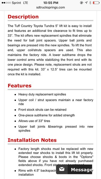

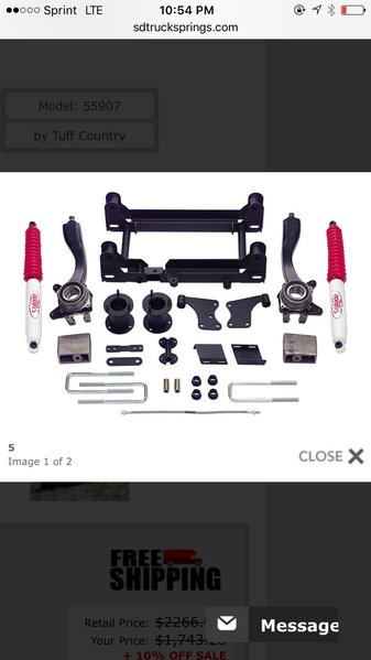

    How's that when the spacer is on top ? A stock strut only has 4" 9/16 of exposed rod. I went and measured a stuck one at the parts store. Mine has about the same amount showing . The space is hallow and the strut still bolts to the oem location. Pluse I have not seen a coil over that's going to lift my front up 5 inches. This lift is not just a spacer . It has a new lower cross member....

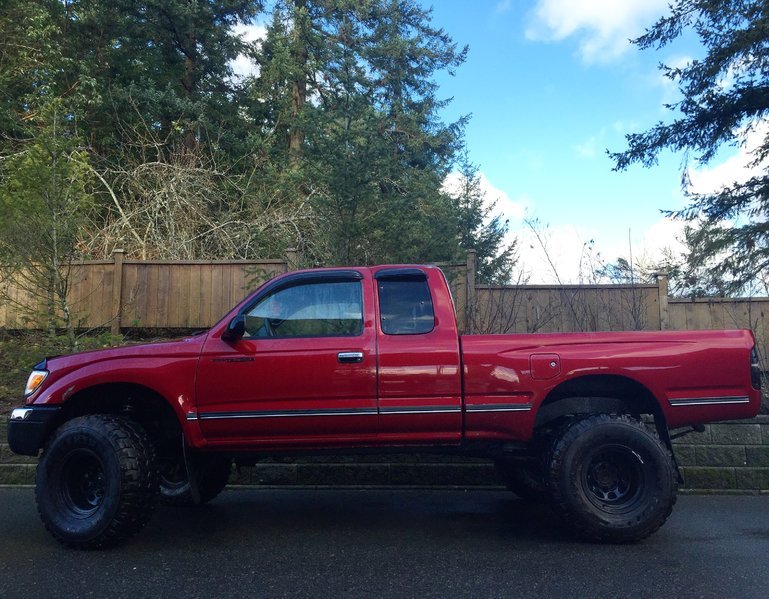

    Did RCD Billie 51ks on my 03. I got 1 3/4" out of the middle of the three settings. Perfect match for the Daystar 2" lift shackles on back. Fits 32x10 Grabbers with plenty to spare. And what a great and very noticable improvement. Did rear ujoints and carrier today. It's a Cadillac, now! I'll get a fresh pic up asap

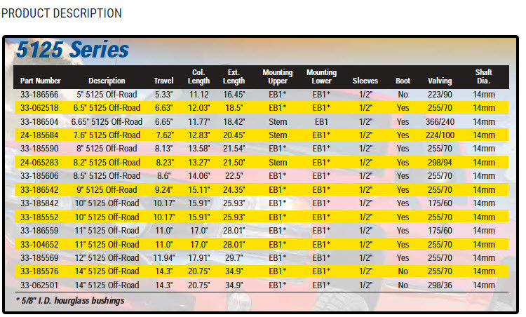

    I have a '04 tacoma 3.4l v6 4wd. I have a 3in skyjacker lift. Does anyone know if the Bilstein 5100s will work? I think the extended length for the skyjacker shocks is 24.94inches. Does any one have the extended length of the rear bilstein 5100s.

    I think I found my answer and because I have replaced the full leafs I need the 5125s which closely match the old skyjacker shock fully extended length. In my research I found this chart for reference to bilstein shocks.
