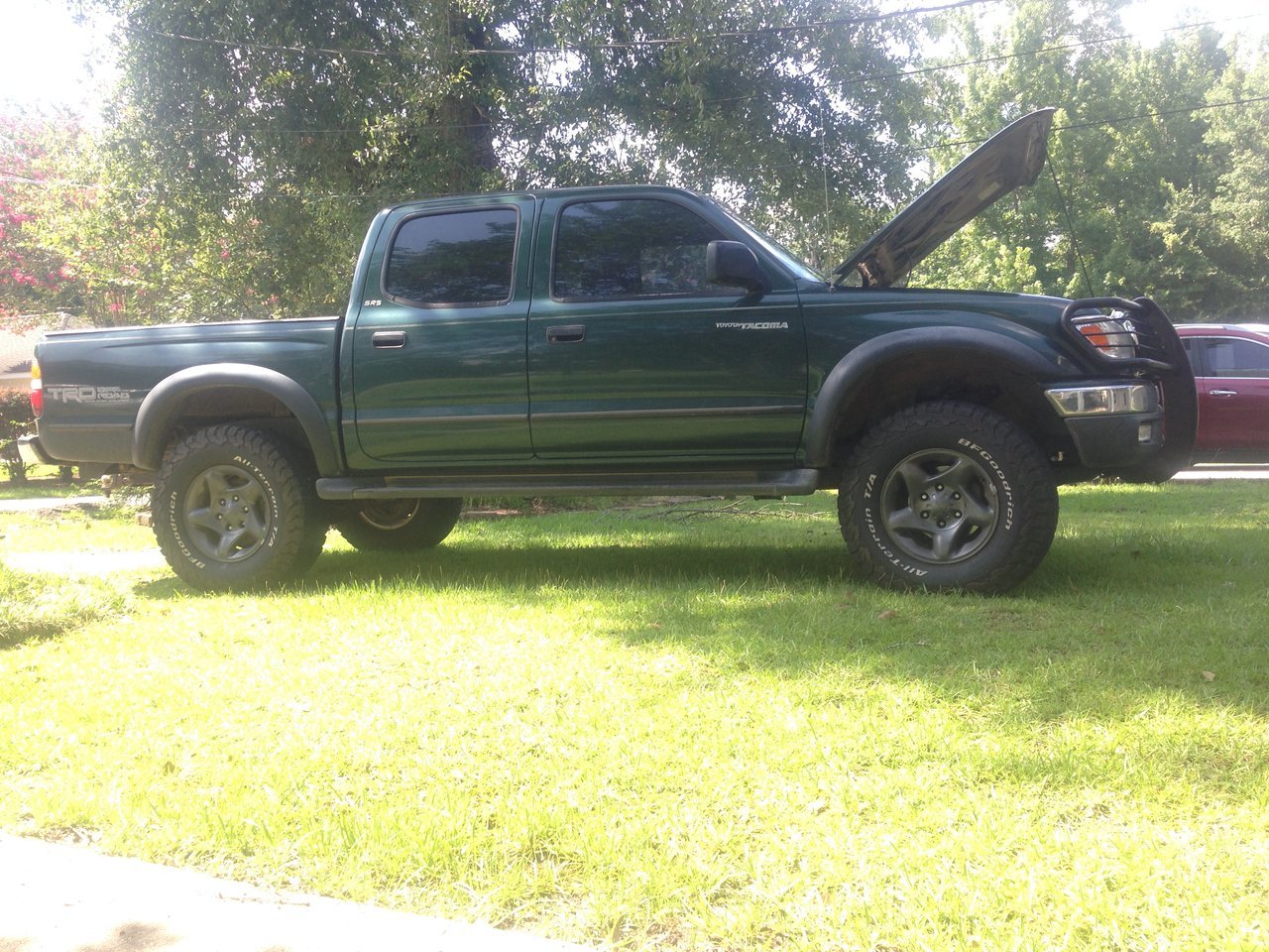

    Here is my truck when I had my Bilsteins on the 2nd setting

    Hey what about the rear? Any lift? also, what size tire and wheels are those?

    heck yeah! That look good! What setting did you have them on? And what coils?
