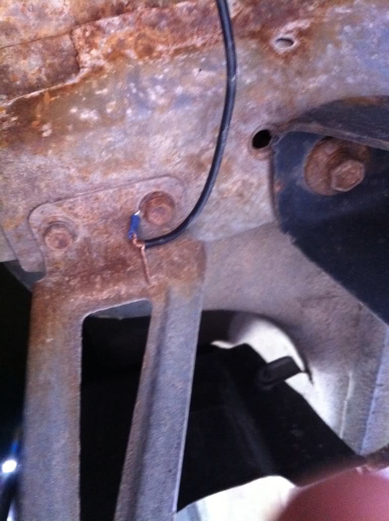

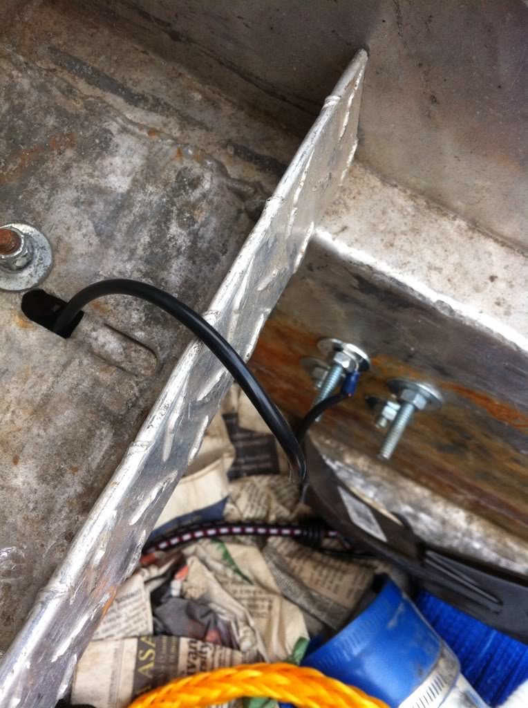

    When you mount it to your tool box make suee either your tool box is grounded or you have a ground wire ran to your antenna mount or you won't pick up anything. The way my toolbox is mounted to my truck I had to run a ground wire. I started picking twice as much on the air.

    agrant2312
    agrant2312 Well-Known Member
    Dec 24, 2011
    #69327
    106
    Austin
    Nicholasville, KY
    96 Tacoma 3.4l 4X4
    Intake, Flowmaster Exhaust
    Yep this is a pretty crappy job did it in about 5 min.
    Back of the antenna mount on the inside of the toolbox.
    Closest bolt to the antenna on the frame.

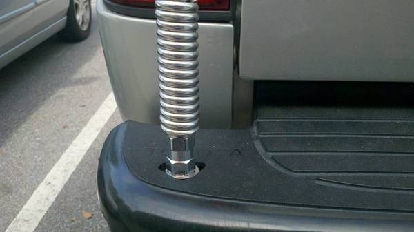

    2005 TRD Sport
    thinking of moving the antenna to the rear bumper, anyone have an experience/pics with this?

    UPDATE!
    Moved the antenna to the rear bumper for clearance in and out of garages

    What diameter hole does a Firestik need? I'm working on my custom rear bumper and want drill the hole now since I'll be powder-coating later.
