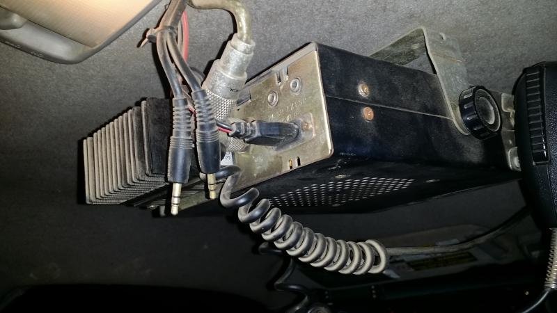

    I am trying to figure out a way to install my Cobra 25LTD on the ceiling of the cab of my truck.... and run the coaxial through the mirror mount and cross over and run it down the "A" Pillar.
    The problem I am running into is that I want to be able to remove the bracket and radio so the only solution I can come up with is to drill a hole in one of the ceiling ribs and some how permanently attach a nut some how and putting the headliner back up and punch holes in the head liner....
    Has anybody ever attempted a project like this?

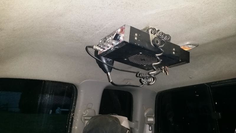

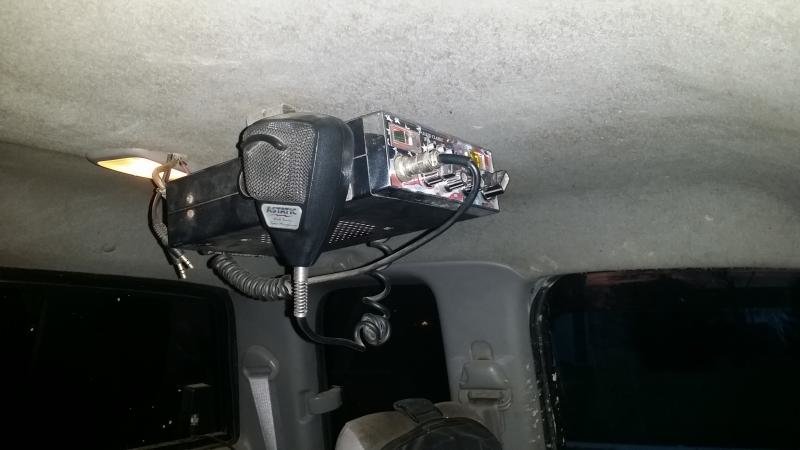

    I have the same mounting, same gen, same radio with a kicker on it. I'll try and get some pictures tomorrow for you.

    Thanks for the pics! Nice install too!
    If you don't mind me asking, how did you attach the radio bracket to the ceiling?

    I have an 1/8" 2"wide aluminum flat stock bent to follow the roof body lines. It attaches at both the map light holes as well as the backseat cargo light. Two holes were drilled and tapped for bolt heads so that nuts could be used. Thats how the radio attaches to the aluminum.
