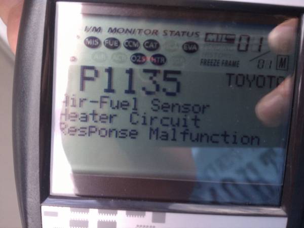

    Took it out to my uncle's car lot to see what it's saying and this is what I got

    Bad AFR sensor. It would be a good idea to change both that one and the rear sensor. You can get them cheap and quick at www.rockauto.com They have a member discount in their vendor section. Get the Denso as they're OEM. Toyota's don't like Bosch or universal sensors.

    Cool deal. So this is just usual wear parts going bad with age right?

    Correct. That's why I advise you do the rear one also. You don't have to, just my .02
