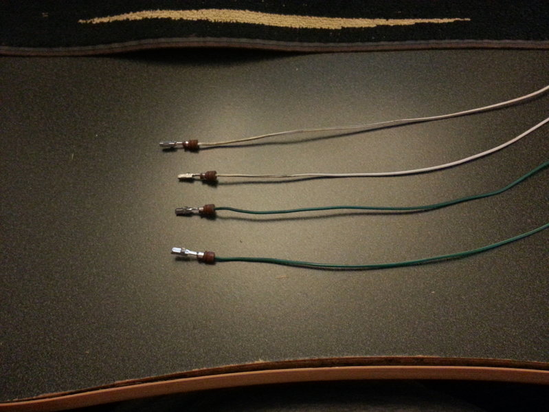

    reason for the dual filament is state laws. you need lights on for indication and then it'll also work as the turn.
    the stock housing plug only has two wires so that's why many use a different socket.
    you can mod the original turn signal but either need to run a wire through the rubber seal for the third spot or get a donor set and use the wires from it
