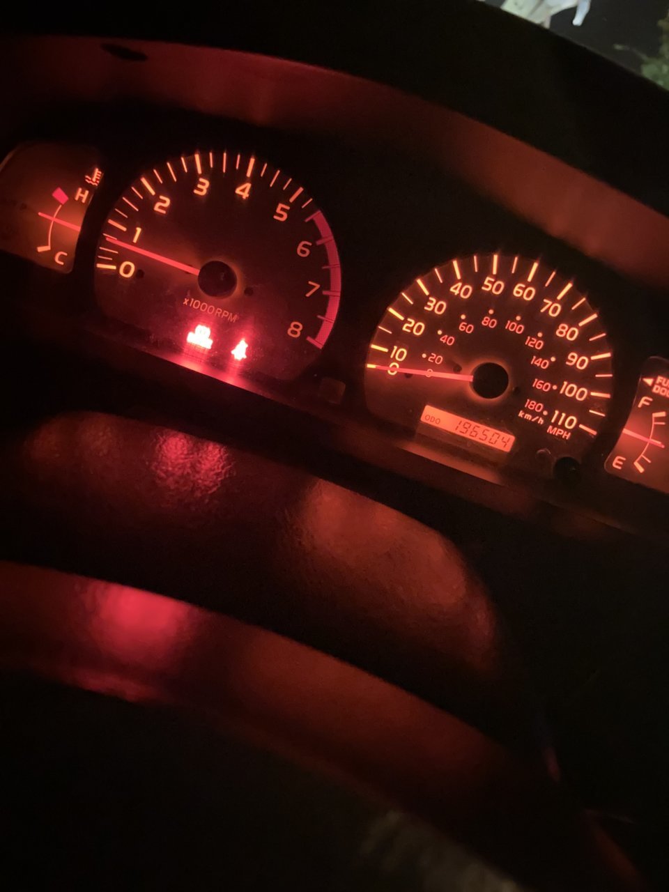

    Im kinda new to my Tacoma it’s a 2002 are the lights on the Rpm normally dimmer after around 5k rpm

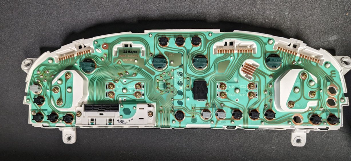

    Does someone know what type of light bulb is used for the check engine light, oil light, brake light, seat belt like, etc... ?
