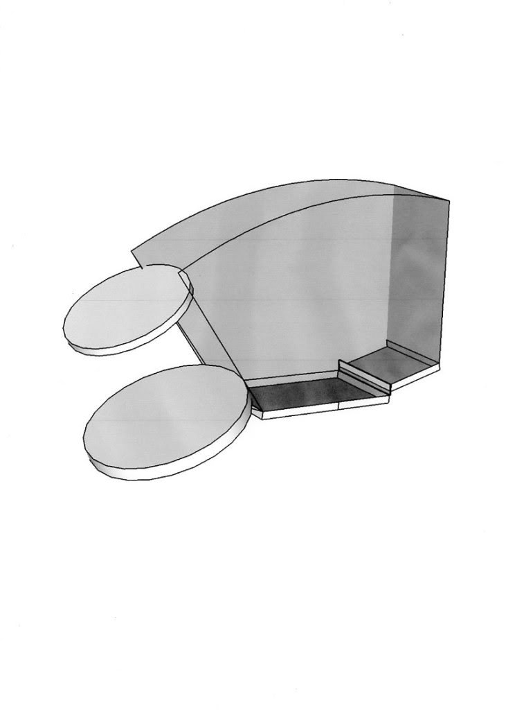

    Ok up date here is a basic sketch of the MDF frame work. The rest will be fiber glass and is custom so i will have a final shape when I wrap it in fleece. I'm kinda going off the JL design but I'm going to enlarge the top where the magnet will sit so that it will accommodate most 10" subs and add a little more air space. I will have some photos this weekend of the frame work in my truck maybe even wrapped so stay tuned.

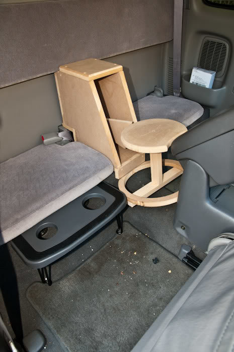

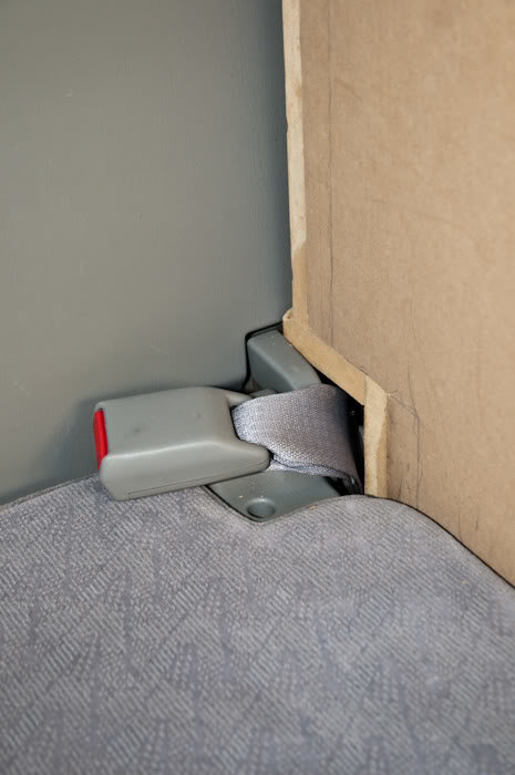

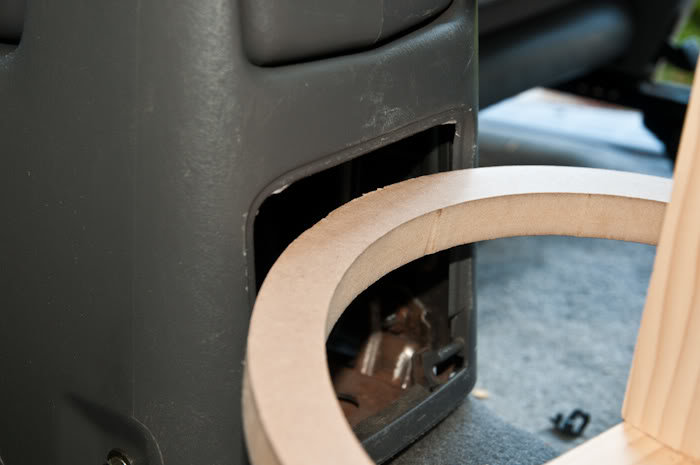

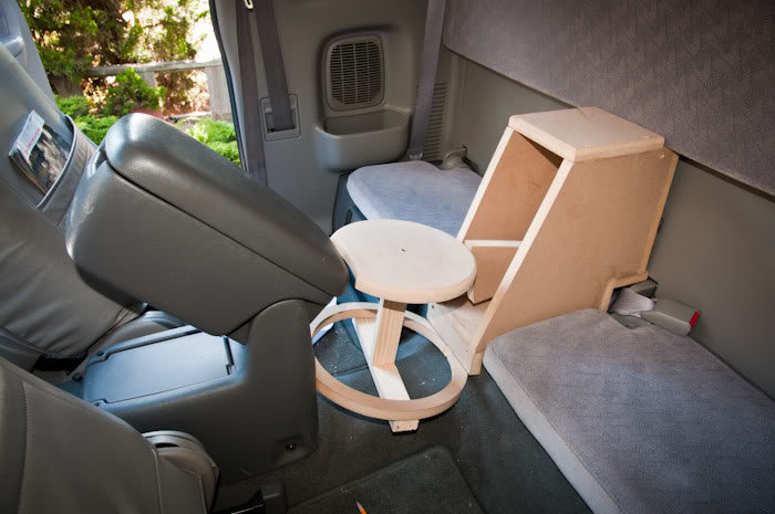

    Okay update.
    I built the frame work for the box today and it turned out pretty good it fits like a glove. Here are some photos of what the frame looks like in the truck.
    Disregard all the bracing that's just to get a shape with the fiberglass it will all be out tomorrow.
    I made the box with just over 8" mounting depth so just about any 10" should fit.
    (Note) you will not be able to open the center console all the way but as you can see it's still accessible.
    Another thing I also made it so you don't have to remove your cup holders like the JL box.
    Relocation of the seat belt buckles. They are still bolted to the factory location just moved from the clips on the back wall.
    Another thing you will have to remove the storage bin behind the console it's pretty much useless anyway with a box in this location.
    Stay tuned glassing starts tomorrow then you will really be able to see the shape.

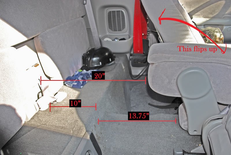

    My 01' SR5 don't have the storage under the console or the storage place on the back of it. This will fit in an 01' also I assume?

    Can you post a pic
    Also can you measure the distance from the back of the console to the seat hump?

    On second thought I don't need the pic if your saying your console don't flip up like mine your fine I can just adjust the angle of the sub ring and it's will fit just fine.
    Just to be safe can you take those measurements?

    Here's how the SR5's are made...
