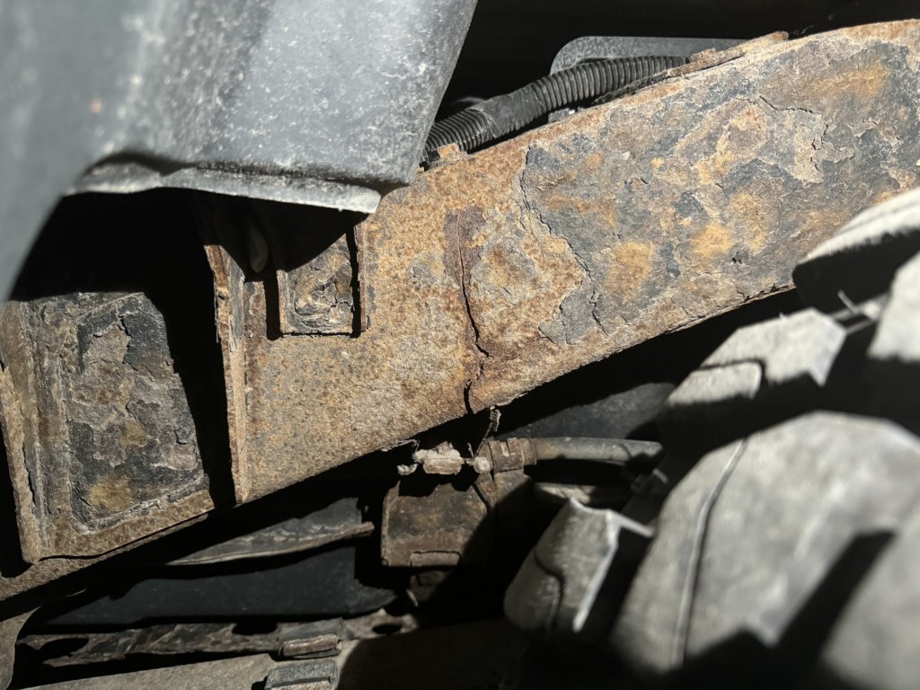

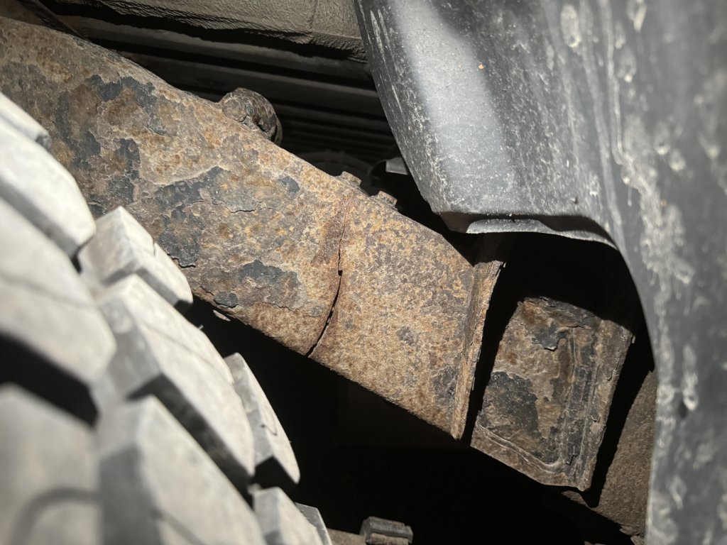

    Just discovered my frame is cracked, both sides same place.
    2004 Double Cab TRD.
    Bought new in 2004.
    218 400 km (135 700 mi).
    In Calgary Alberta (salt not used on roads).
    All frame recall inspections and repairs were done according to Toyota. Vehicle is well maintained by Toyota Mechanic.
    I’ve contacted Toyota Canada asking how they will help remedy…
    Has anyone had their frame crack?
    Is it repairable at reasonable cost?
    Thank you.

    That could be repairable, perhaps. But not likely worth it and may not be if there's not enough adequate quality metal left to weld to. You'd be better of looking for a clean frame to swap your truck onto, or just selling your truck as a parts truck

    Many people have experienced this.
    What's a reasonable cost? To someone, $4,000 is reasonable, to others it's enough to jump ship and sell the truck. Could cost more, or less, depending on who you go to.
    Looks like the frame has been neglected indefinitely.

    It would take some time and patience to get underneath and knock off all the rust you can to expose any clean and solid metal.
    Removing the bed would give you all the room you need to get at your rust, while allowing you to assess the rest of the frame. Only then should you be able to see what all you will need to reinforce/replace, and decide if you want to go through with it yourself or get it done by someone else.
    The labor of removing parts, clean-up and prep should be the bulk of your cost. Followed by the cost of material (the reinforcement plates above for instance) and labor for welding said plates on.
