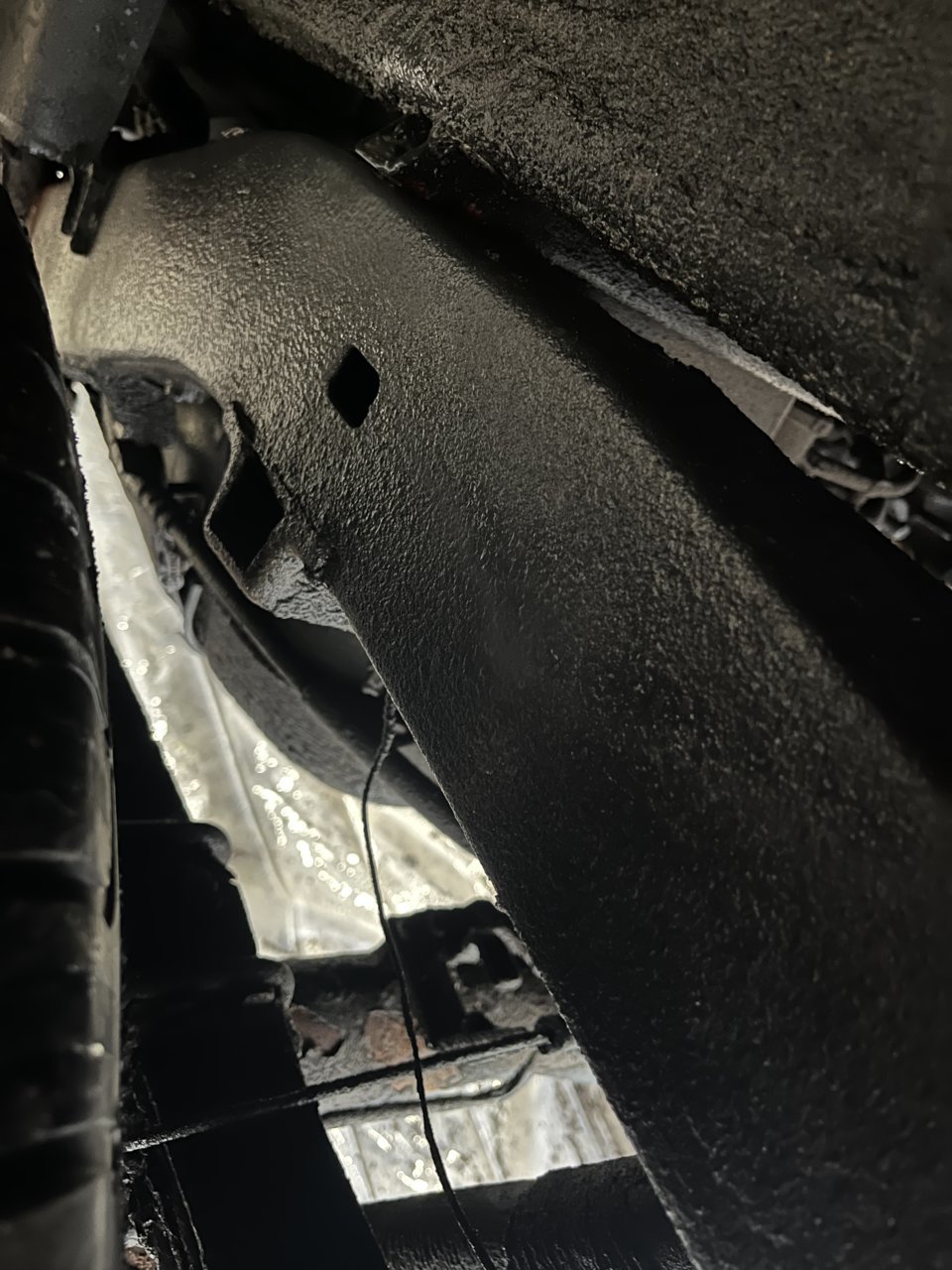

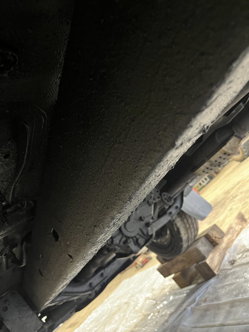

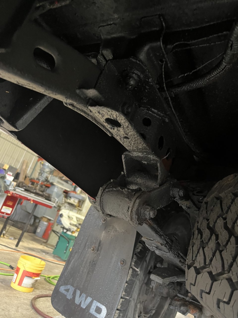

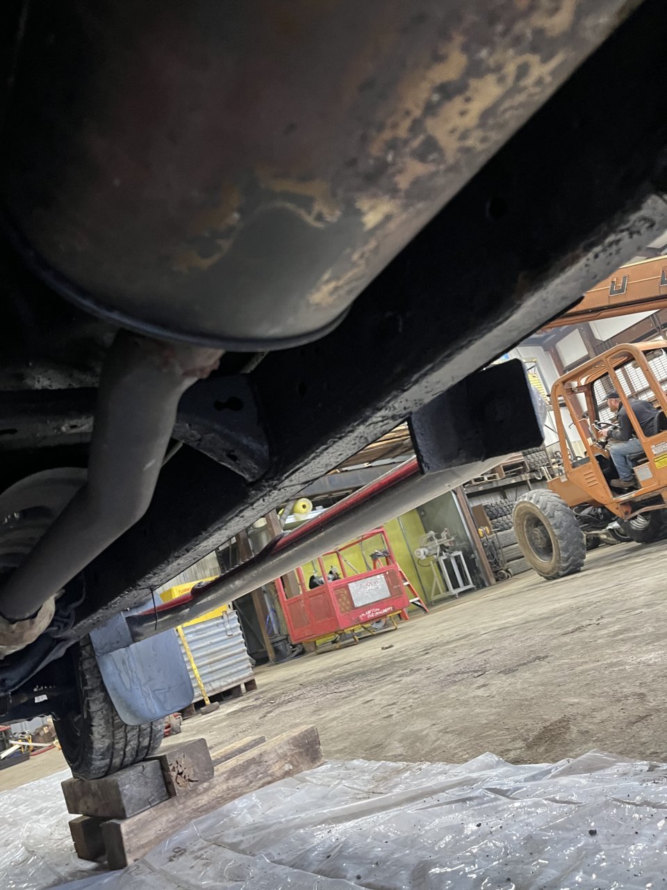

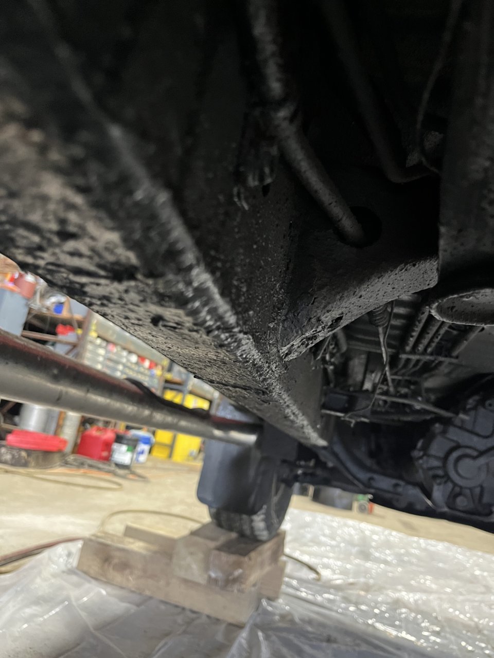

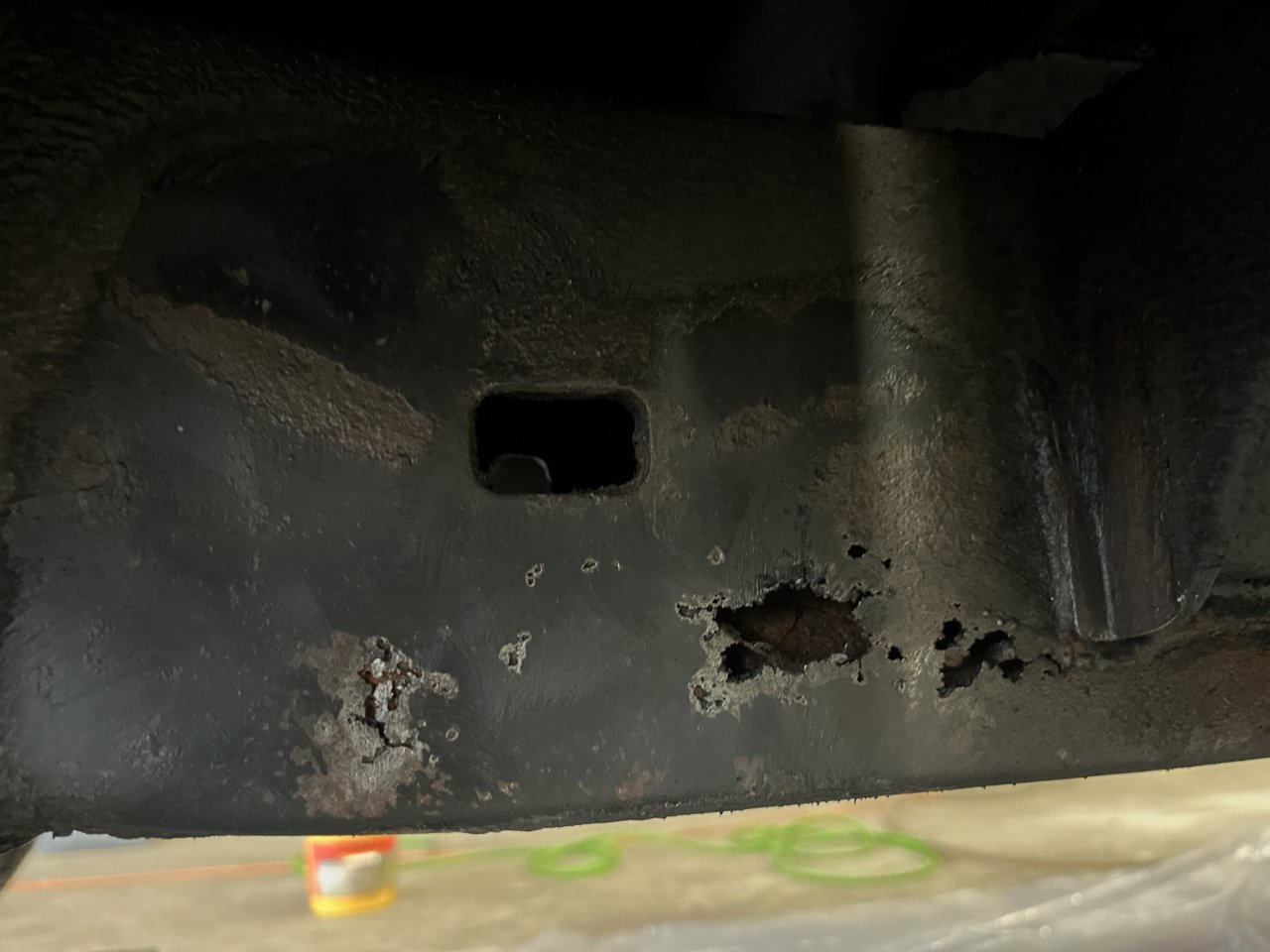

    Ok so I’m sorry for the delay but today was the first day I could get it up in the air a bit to take photos. If anyone is still around and could chime in with an opinion I’d be grateful. I for sure found one hole by the rear cab mount on passengers side so I’m ordering the SafTcaps for that section both sides. Thank you all for your comments.

    Safe t caps. the frame is not terrible not good

    Go hit everything with a ball peen hammer to find any weak spots that arnt easy to see
