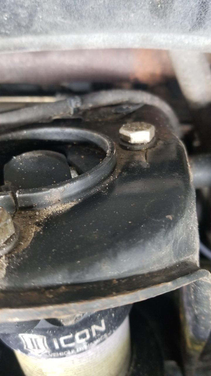

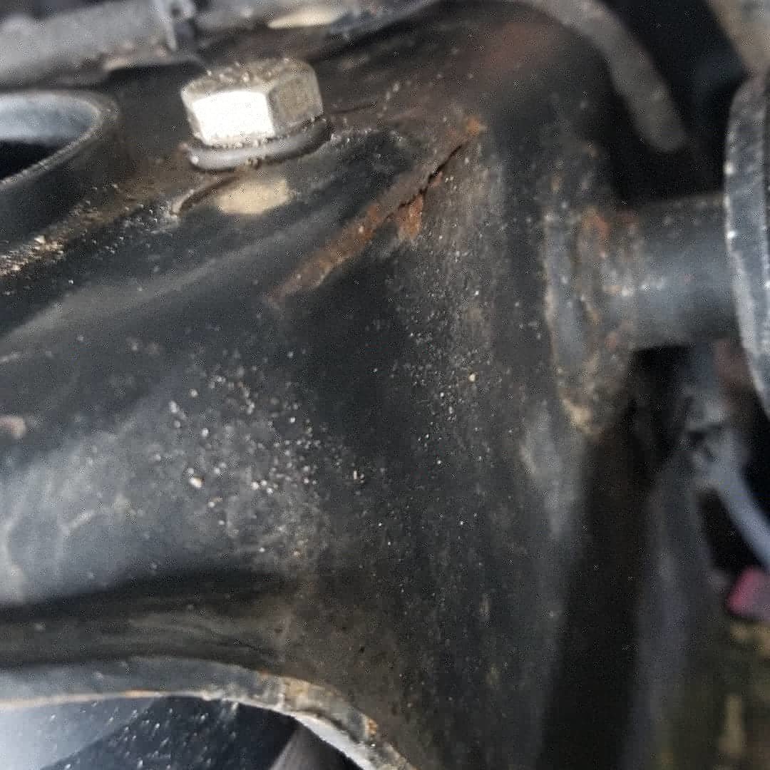

    This past weekend I found that one of my strut tower buckets was cracked. After searching for what others have done, I found that there weren't many pictures of the fix or recommendations for the fix.
    EDIT: it's way more common than I thought.
    Here's some examples
    I did notice that the 4runner folks had quite a few of them. So, since the 3rd gen 4 runner and 1st gen taco's have the exact same front suspension, here are some things that I have found to be helpful.

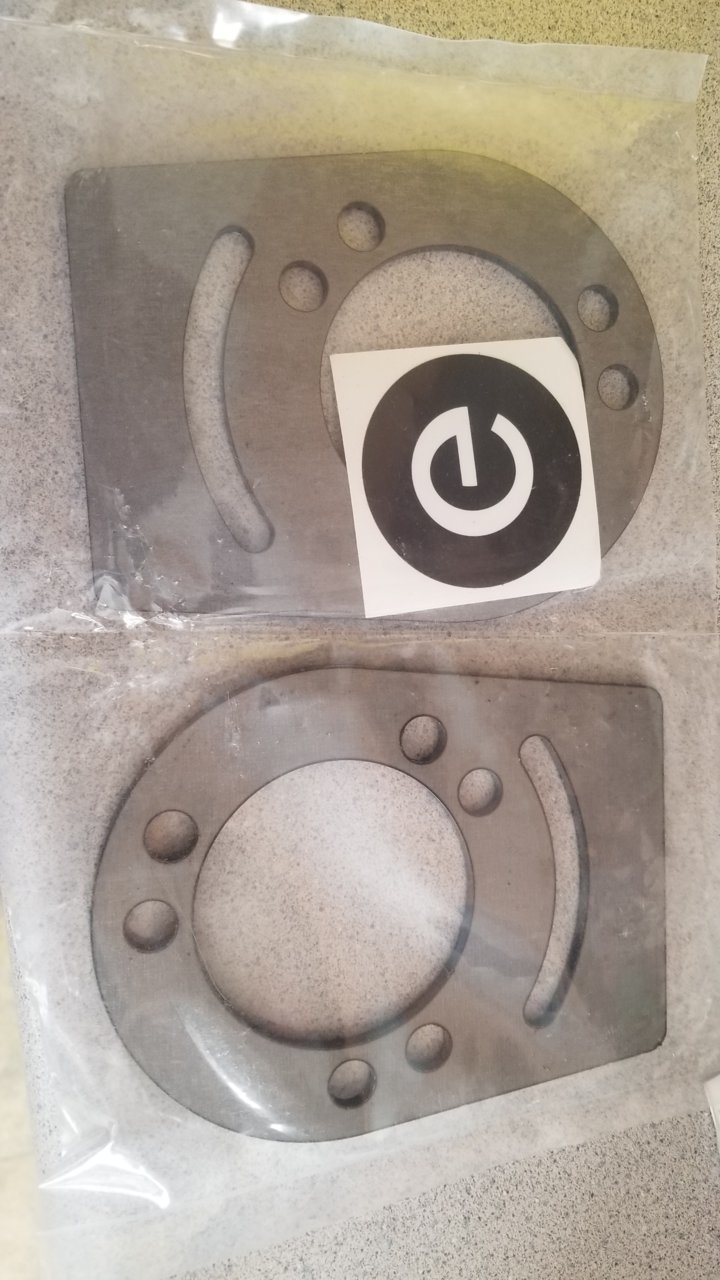

    • Lower control arm reinforcement:
    EIMKEITH has this weld on kit. I haven't seen it installed but as soon as I can I think it will be on my rig. Lower control arm reinforcement

    Strut tower reinforcement:
    • Total chaos has a weld on kits for our suspension.
    I think both of these would be something that we all need eventually but I would get your butt out there and buy the one from EIMKEITH.com before you have serious issues.

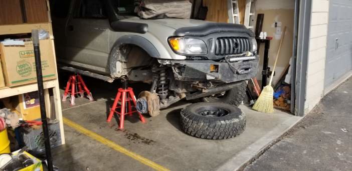

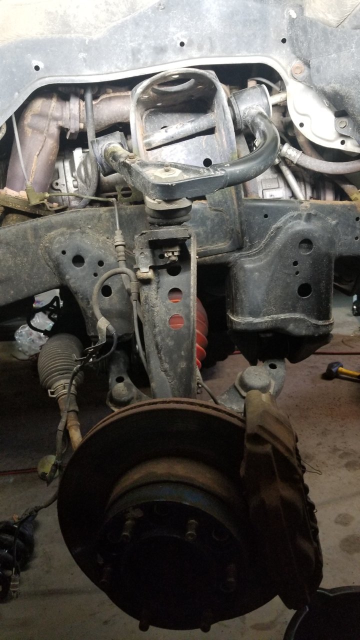

    Because pics
    tacoma strut bucket 02.jpg.jpg tacoma strut bucket 01.jpg Tacoma strut bucket 03.jpg Tacoma front rebuild.jpg Tacoma Icon fail 01.jpg Tacoma Icon fail 02.jpg

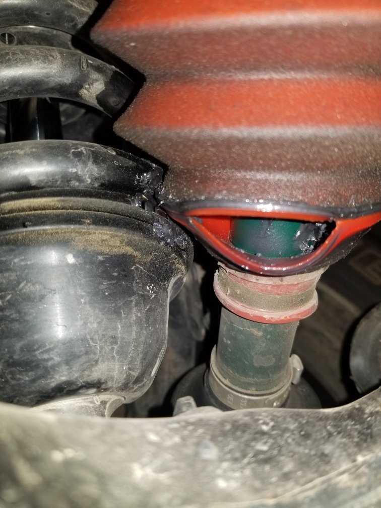

    This one is because I didn't think that the boot would make contact with the larger shocks. Learn from my mistakes

    About to go weld these on.
