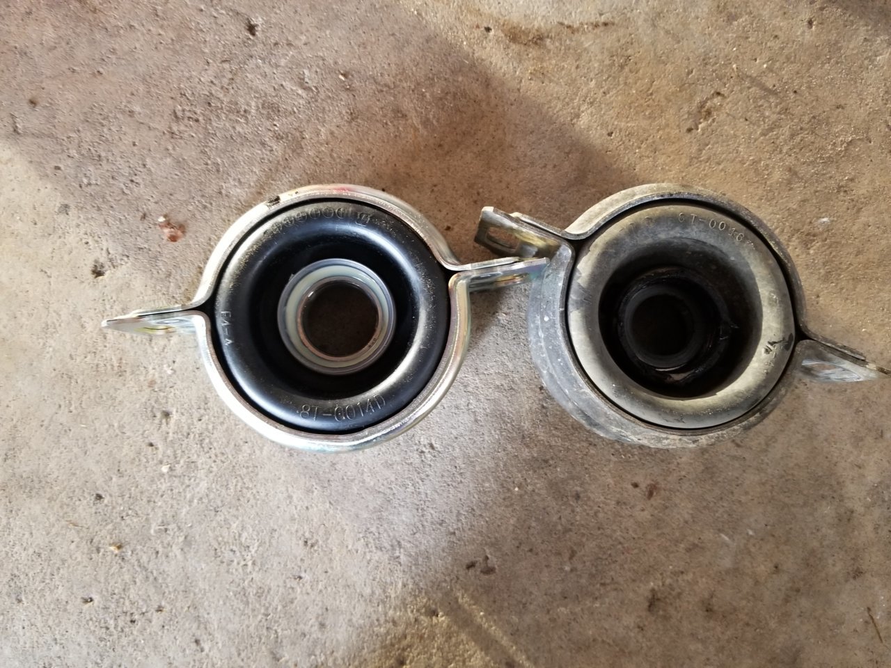

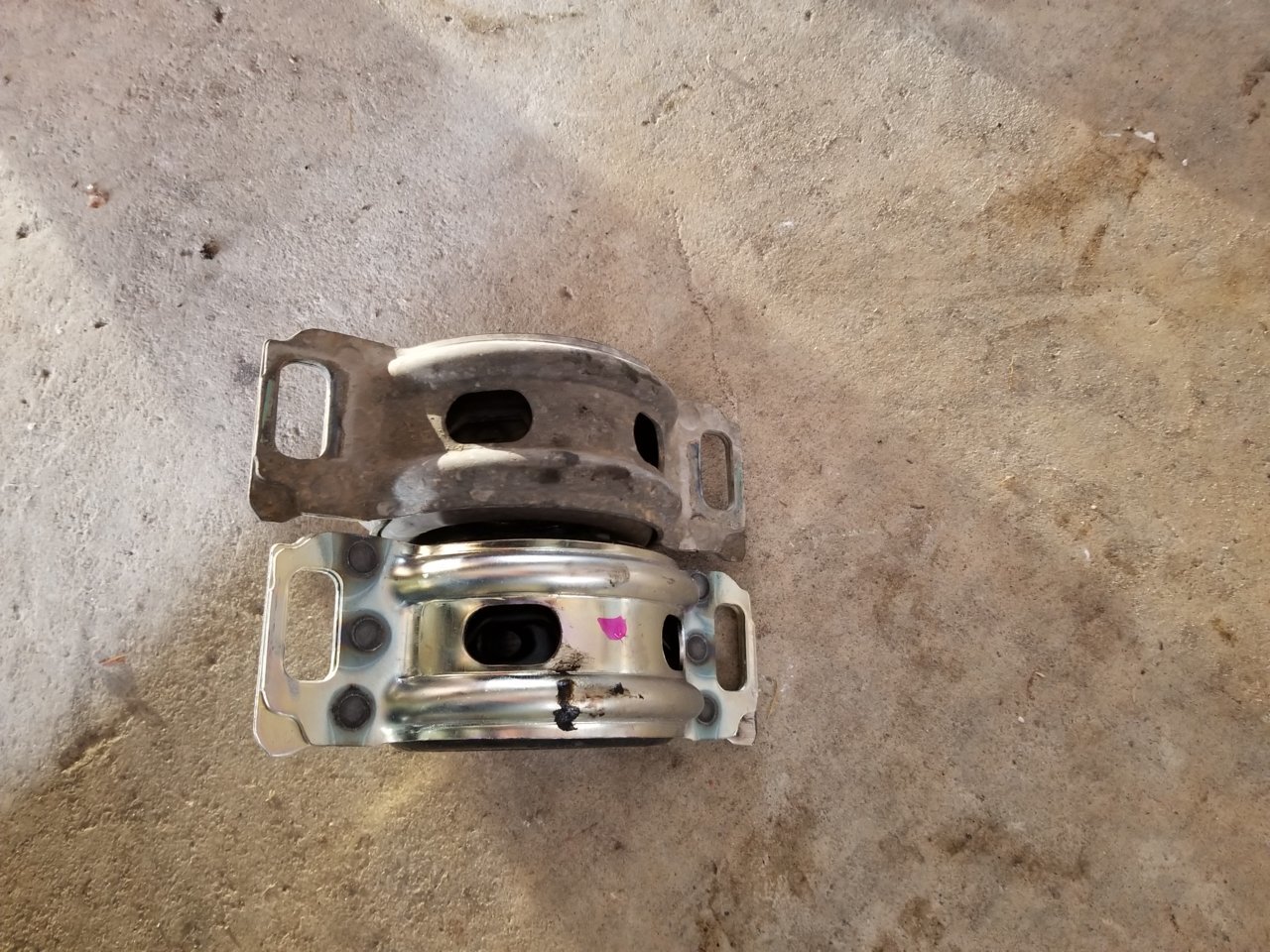

    Slapped this puppy in. Fixed my ~25mph vibes and more importantly didn't introduce any new vibes! I'm ~1" lifted in the rear on Wheeler AAL and Bilstein 5100s supporting the old factory leaf springs.
    The sag in the old part is more apparent in person than it comes across in the picture I think. Old part slide off ezee peezee, no puller necessary. Also didn't need to disconnect the front half of the rear shaft either.
