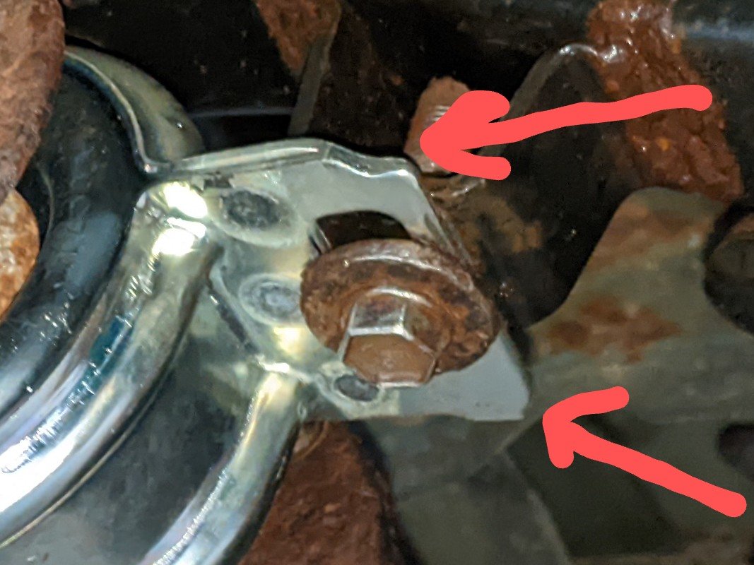

    Is there a certain way this bearing supposed to face? Both sides look the same.....

    Pay attention to the orientation of the fins (not sure exactly what they are called). See the attached picture. This is from the front looking towards the rear. Check on your vehicle before taking it off.

    Well I would but I'm replacing a Doorman that only lasted about 200 miles. I'm putting a new OEM one on. Thanks for the pic, I see that on my new one.
