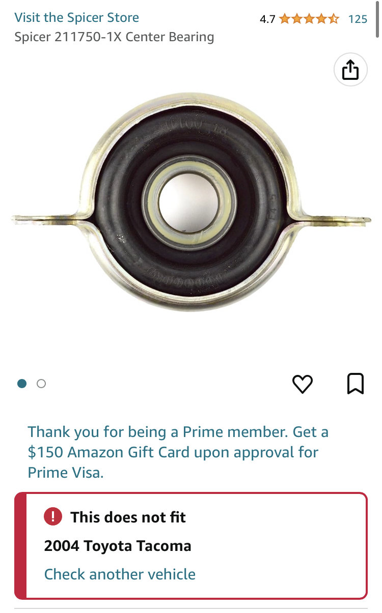

    Amazon says it does not fit my vehicle

    Amazon is wrong a lot. Read the reviews.

    FWIW, if it's sold and shipped by Amazon then it's a legit part. If it's sold by a third party, I'd treat it as suspect and do your research before ordering.
    This is the one I purchased back in 2019. Just put it on recently and have had ZERO issues with it.
    NOTE: Sold by AMAZON :thumbsup:
    https://www.amazon.com/gp/product/B00GAPFD2E

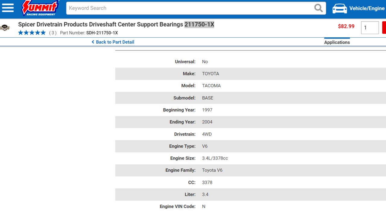

    Not saying it is or isn't correct but Summit lists in their fitment notes for Spicer 211750-1X that it is compatible with 97-04 4WD Tacomas (in addition to the T100, Tundra, etc.).

    Like I said "it does fit and work" but it is most definitely not the same.

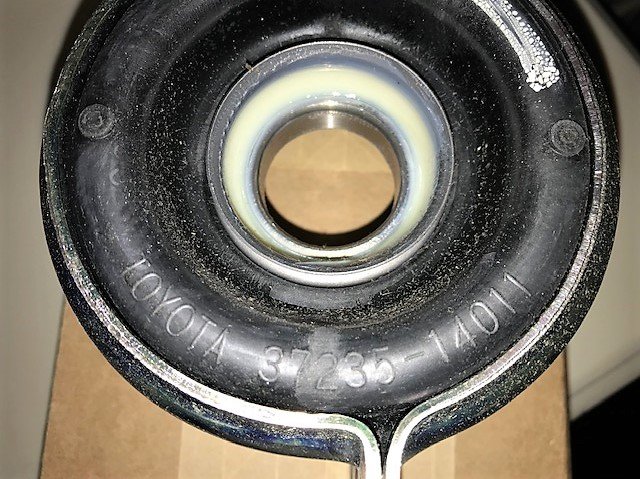

    That Spicer 211750-1X center bearing was installed on my '97 V6 Taco 4x4 5 speed manual last summer. The box was marked JAPAN, the bearing was marked "TOYOTA 37235-14011", it fit perfectly, and is working just fine. I ordered it from SUMMIT with a couple jugs of Lucas gear oil to get the free shipping.
