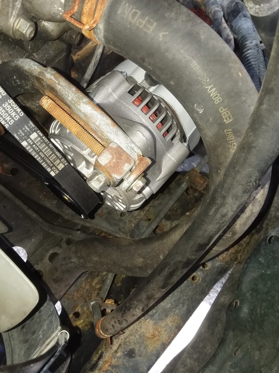

    This is 1997 2.7l after having alternator replaced had issue of belt being too large. Shoulda read this post first.

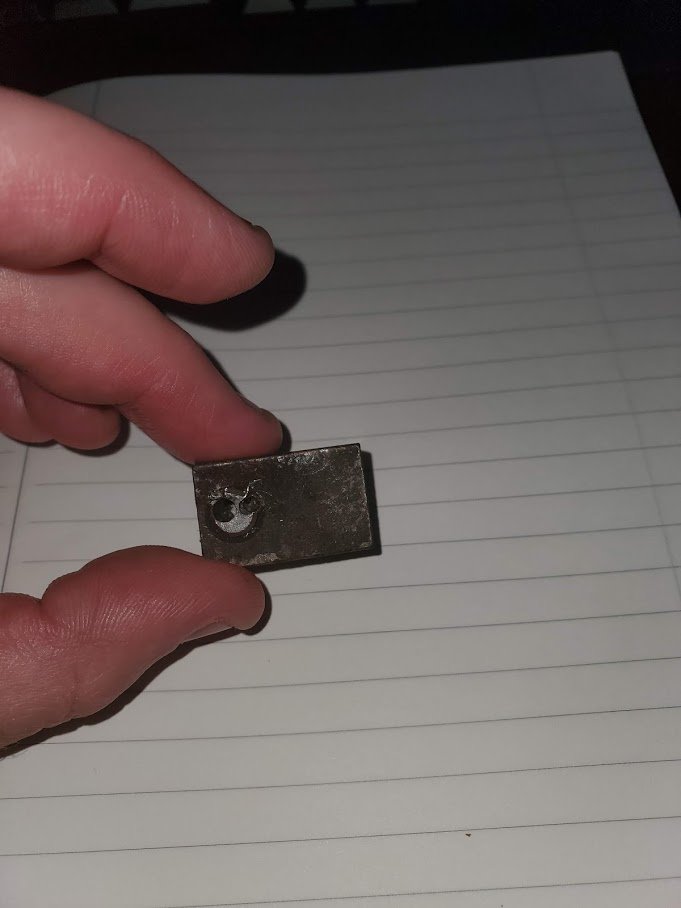

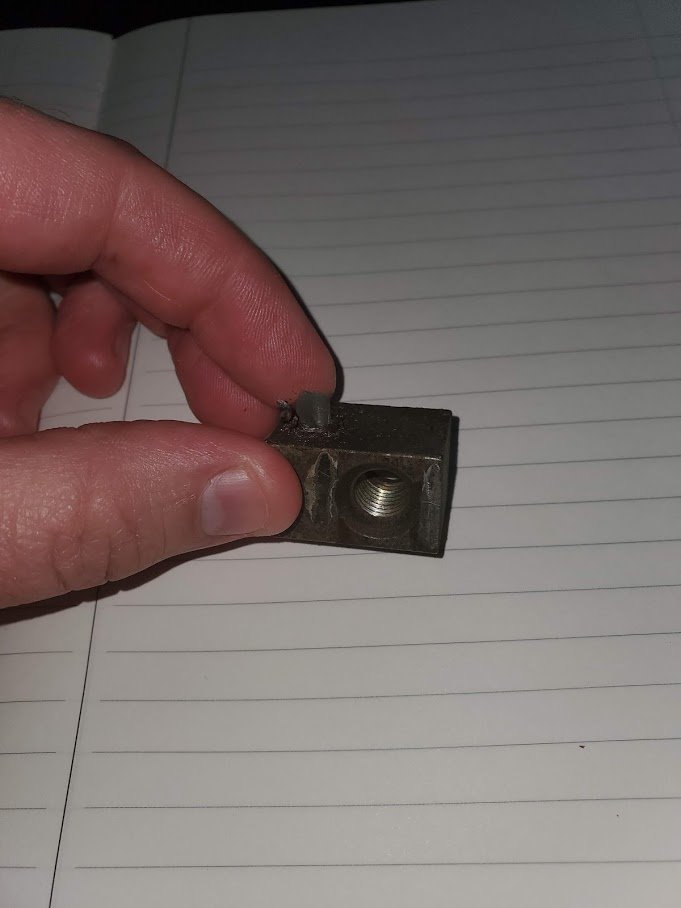

    Hi All, first post on Tacoma World. This thread has been a great resource in changing the belts on my '97 2.7l.
    Unfortunately I broke the bolt off in the PS tensioner... and then I broke 3 extractors and was unable to drill out the broken bolt. Does anyone know what this part is called or part # or how I might obtain a new or used one?
    Thanks! -Tim
