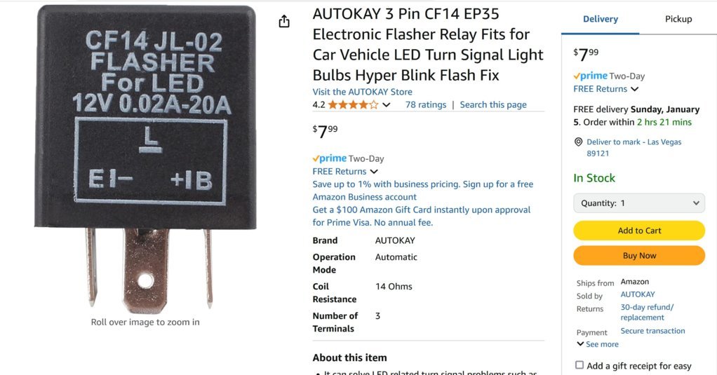

    This one from Amazon is $7.99 and works ok.

    I recall my Amazon iJDMTOY CF14 had that characteristic. Get the adjustable one I linked, it doesn't have that weird start hang-up and it has a little built-in rheostat so you can dial in exactly the blink duration you want.
