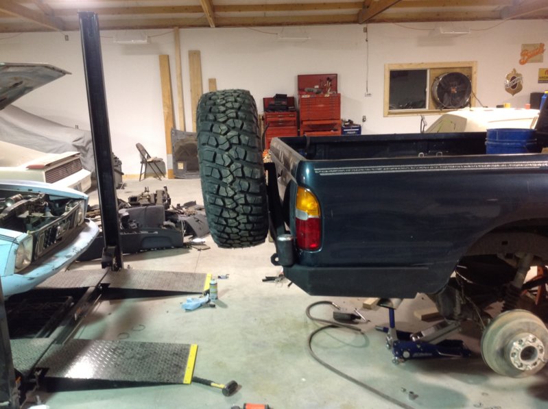

    oh gotcha. Yea i can get that. Should be about to get it skinned and a support brace there and barely gave it below the bed side..Im struggling to find photos of mine to show the clearances...
    [​IMG]New Bed Rack-85.jpg by Monte Nickles Photos, on Flickr
    [​IMG]IMG_9017 by mike digirat, on Flickr
    [​IMG]IMG_9060 by mike digirat, on Flickr
    [​IMG]M~D~U-4.jpg by Monte Nickles Photos, on Flickr
    Not trying to tell you how to do it of course :oops: just feed some inspiration i hope :p But you can keep it pretty tight to the body with the side brace i guess is the point. Tighter then any tube sides. Can get more photos of the undersides of mine and Mikes rig if you want.
    But i will say, i'll take the 1/2'' or less clearance to have the whole bed side covered and supported over having part of it exposed to rocks. Also would love it if no cutting was involved...

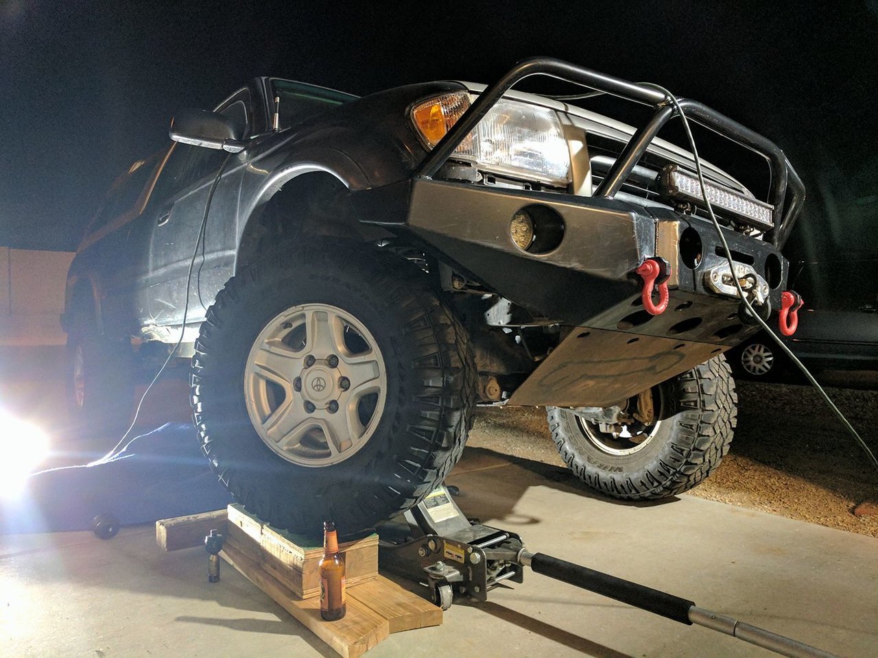

    Just my 2 cents, while we are discussing "adapter plates" in the beginning of this thread.
    I had to cut the front of my frame for my plate bumper from ELITE, however the stock mounts and even the core mounts ended up getting tweaked with minor wheeling hits on the bumper. My solution was custom core support mounts, and custom bumper mounting on a cross member I added, that could be later utilized for leaf hangers if I decided to go leafs instead of coil for the SAS. Would be cool to see a beefier mount system implemented I guess is all I am trying to say.
    In other news, My elite because I cant let @Blackdawg \ Monte being the only one to swing his ELITE dick around :cheers:. Mine at least has a real dick. Jus' saying.
