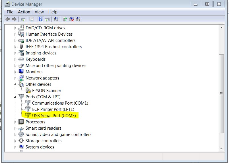

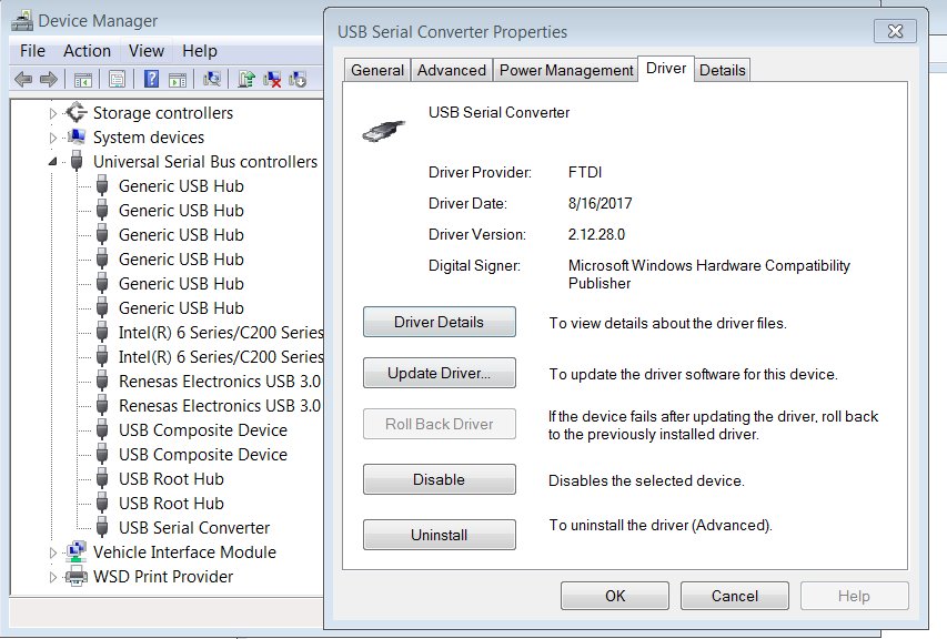

    Here's an item that may be in conflict on my USB serial port. I have an FTDI driver installed for the USB serial converter that was part of one of my desperate attempts on Friday.
    Do you show a driver for USB Serial Converter? I've had FTDI drivers installed for other software on different laptops.
    COM3 appears for the USB Serial Port when I plug in the VCI cable. So as it stands right now, looks like FTDI drivers may incorrectly used for the VCI cable?

    Just looked and mine shows the same FTDI driver. I'm still trying to get it working. Techstream runs fine, it's the communication thru the mini-vci that's the issue still for me. Trying a newer version of Techstream now, v15.22.026. I also have some older versions I might try if this doesn't work.
