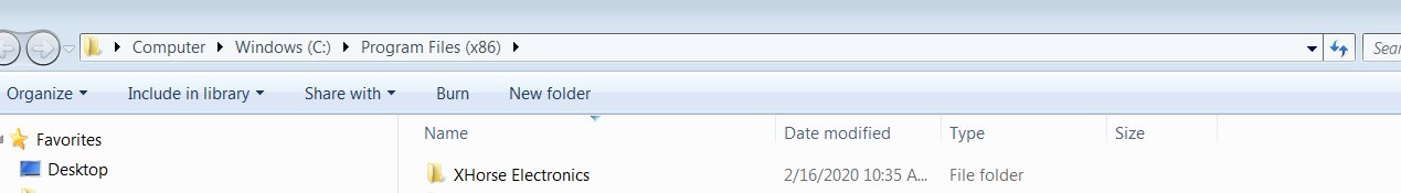

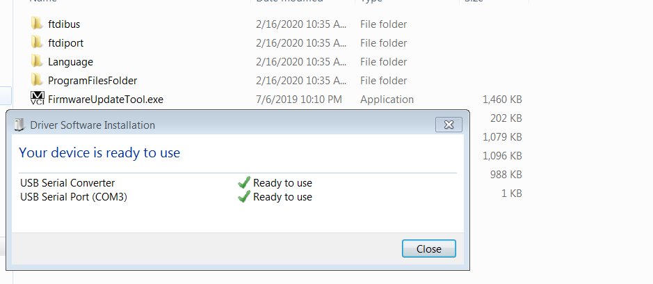

    I removed the FTDI drivers, uninstalled .20. rebooted.
    Copied XHORSE to Program Files x86. Plugged in the VCI cable. Got device ready message.

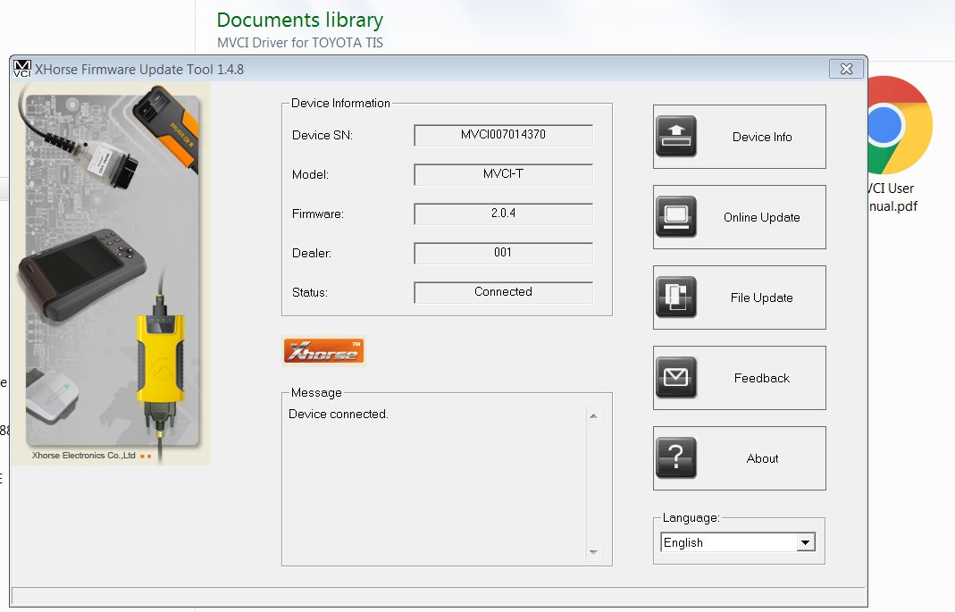

    Next I ran the Firmware update tool to verify the computer is communicating with the VCI device. All good so far. I'm talking to the cable.

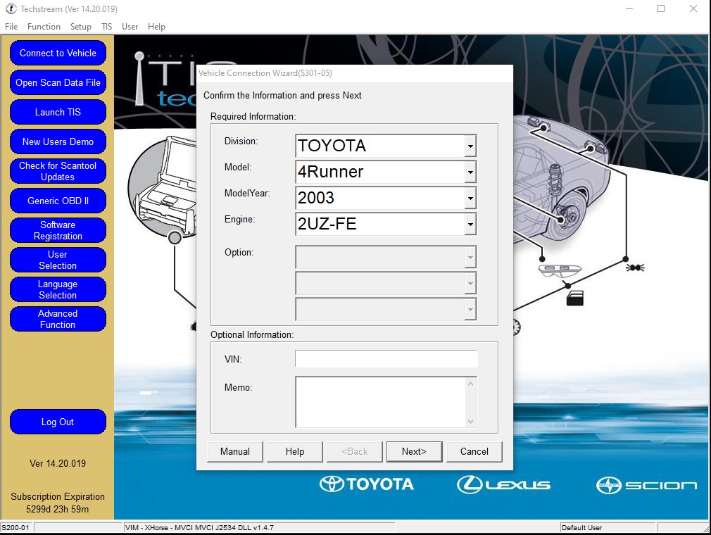

    @CS_AR, got it working!
    Setup the driver stuff first. Be sure to copy the C:\<pathtounzippedfolder>\V14.20&V14.30 -ADX\V14.20&V14.30 -ADX\Techstream V14.20.019\Driver\Driver for 64bit laptop\XHorse Electronics folder into C:\Program Files (x86) first. I think that's the crucial step I was missing before hand.
    I tried 15.00.026 but didn't have anything to generate a reg key so uninstalled that and reinstalled v14.20 again, with the XHorse folder already in Program Files (x86). Once I registered, fired it all up and it finally connected to the truck.

    I used the techstream-act.exe file in the files from tonered that I grabbed. If you don't have them, give me the techstream ID and I can generate the reg key for you.
