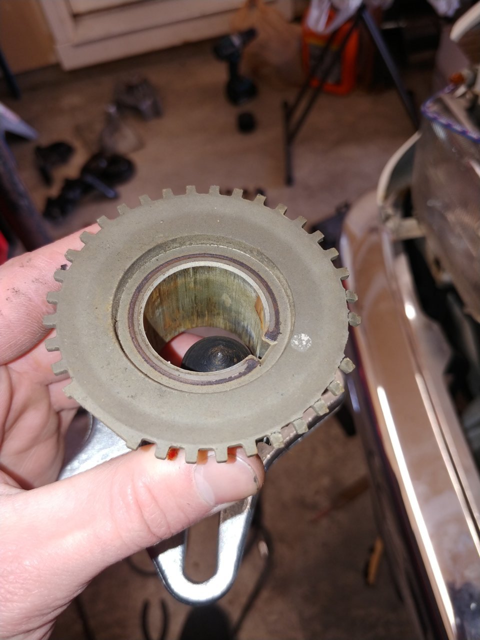

    So what toyota parts site are we all using now for maximum savings. someone tried to pry my crank gear off at one point and all the sensor teeth are bent and one snapped off when I was putting the belt on.

    Really annoying, like seriously, who does this. It came right off with minimal pressure from my puller
    I ordered one from Amazon cuz I need to drive the truck on Friday and I can get it here by Wednesday

    I know, it looks like they tried to remove it with a screwdriver or something. I heard a ting noise when putting the belt on and low and behold one is missing and the others are visibly bent and cracking. I wonder if the timing was slightly off.
