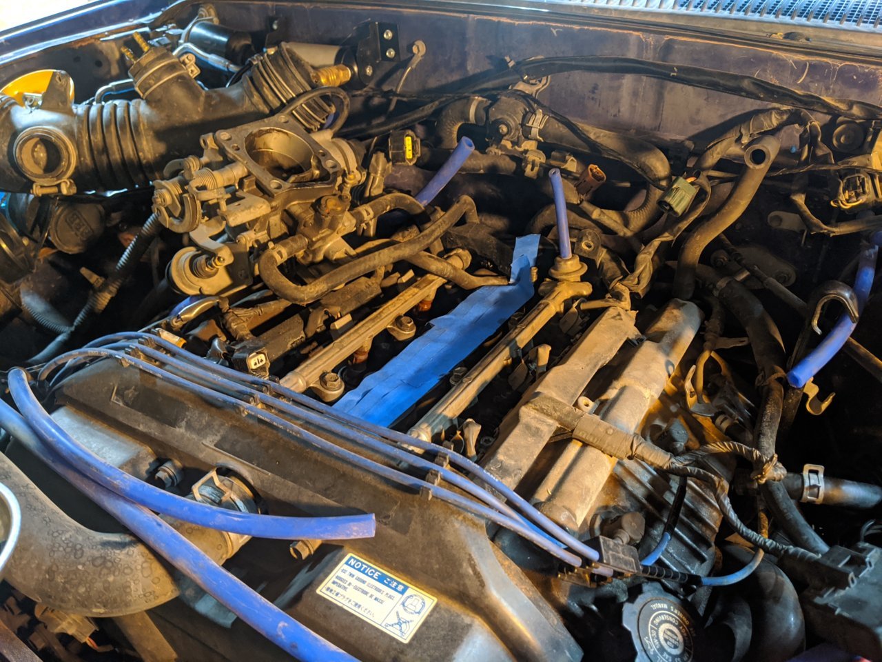

    So where the blue tape is... There was no gasket between the upper and lower intake

    Thats about right id say... after a couple miles my intake was coated in oil
    To stop that run a catch can

    That doesn't look terrible, these engines have a good deal of blowby. Clean it and run it, I'm going to put a catchcan on my 5VZ.

    Running Board Man Well-Known Member
    Feb 19, 2017
    #211024
    8,802
    But how... how did it even run
    Also try taking the tb off with the intake i liked doing that more

    Das bad, lol. Should have been a metal gasket there

    No wonder this thing has always run a little funny
    I hope that she runs smooth with these clean injectors and some new Toyota gaskets. Have been chasing this rough idle and rich CEL code for a while

    That's almost 100% your prob haha
