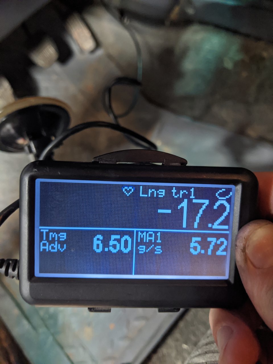

    Truck is idling rompy and smells bad enough that my roommate in the house told me to turn it off

    Checked for vacuum leaks with a propane torch. No CEL.
    Wonder if it's burning off the carb cleaner I used to clean the injectors and intake?

    Spark plugs wires going to the correct plugs?

    Should be long gone, that stuff flashes off pretty fast

    Just checked and yes

    Hmm, sounds like a huge vac leak. Uh booster and all the weird backside vac lines attached?

    Good call, one of the vac lines to the bottom of the tb was disconnected. It smoothed out a lot but I'm not sure it's running as smooth as it should

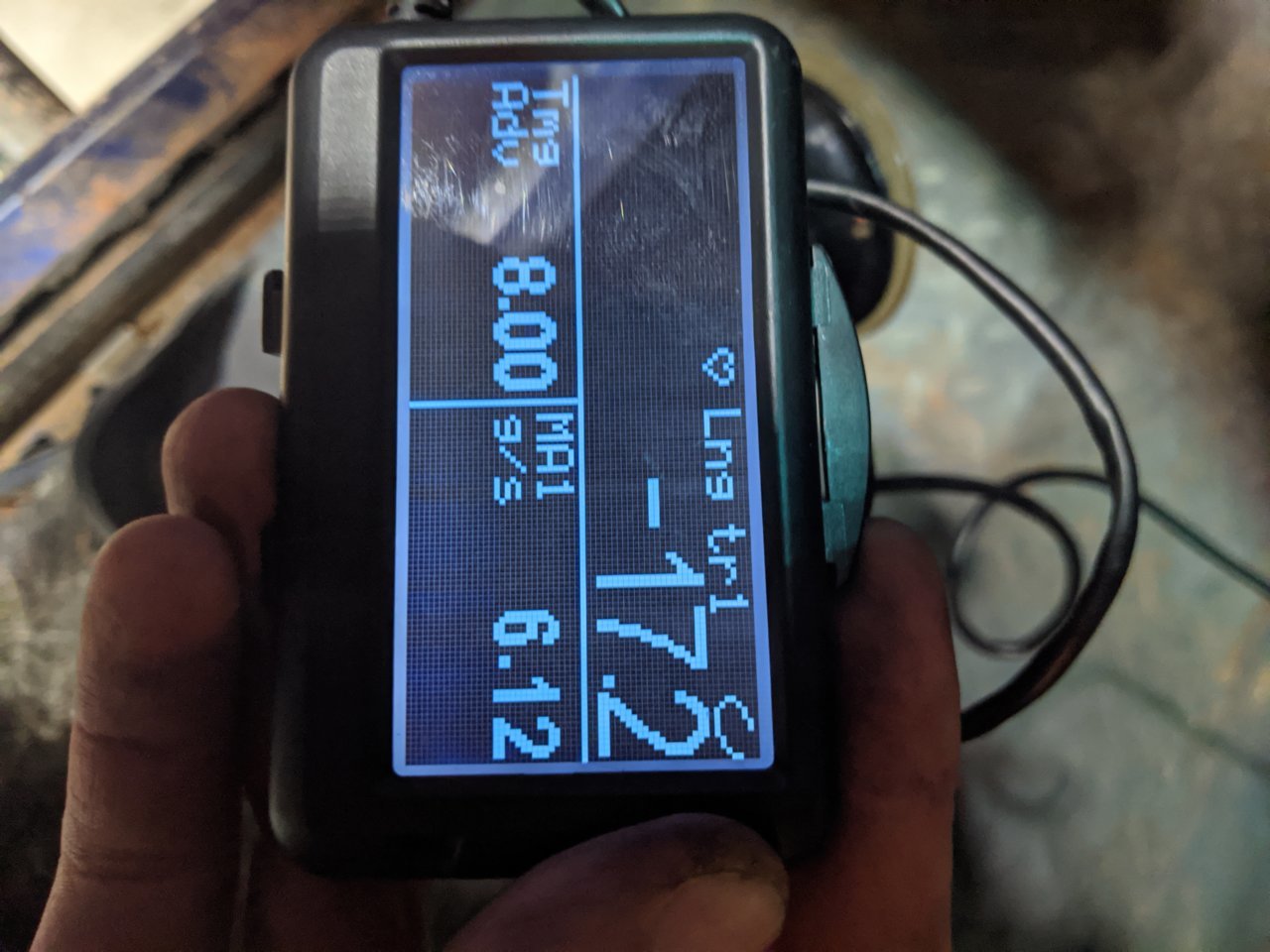

    Trims?

    UG does not show short term but it looks like it's pulling a lot of fuel
