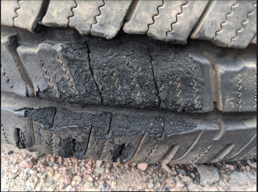

    It seems awfully close to the exhaust too. Wouldn’t it burn the rubber?

    axle dump. As long as the exhaust gas isn't right up against it I don't think it would cause problems, maybe over the course of several years it would be bad for the rubber but a spare shouldn't be kept that long anyway

    happened with my 5 lug over the weekend with 235's lol

    make sure ur exhaust tip is more than 2-3 inches from the tread on the tire.
    5 or 6 lug ur guy's risk will be the same with an axle dump down haha

    Oh man, that was from the exhaust? I thought it was missing chunks from initial observation.

    I had to cut the exhaust bend off because it was rubbing violently on the new leaf springs. It dumps near the tire.

    Exhaust fumes only, not even touching the exhaust pipe. I only had ~2 inches from my exhaust tip to the tire and drove it 10 miles into town and back.
    Figured there is only one way to tell if it was cutting it to close. Charred and burnt to a crisp from those 10 miles
