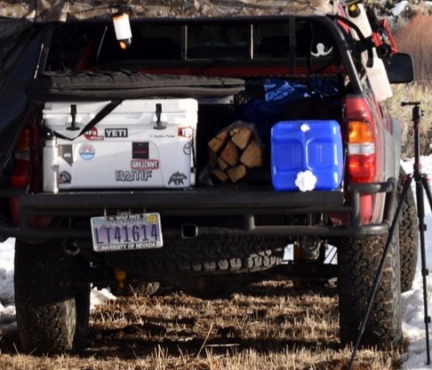

  16. Mar 9, 2020 at 12:53 PM
    NV.ENGINERD
    NV.ENGINERD Well-Known Member
    Jun 14, 2019
    #296327
    65
    Taylor
    04 4x4 DC TACOMA
    Full OME w/883s, Dakars w/AAL, Nitros, SPC UCAs, 285/75R16s
    I fit my full size 285 in the stock location cutting the two tabs off that angle down in the rear (front would have made it touch the axle so left them on). Ruined my clearance a bit but was fine for the 6 months while I planned the swingout
    Best pic below unfortunately. Also did an exhaust chop when installing the new suspension and purposefully kept it a little longer so the hot temp didnt affect the spare
    I don't think a bigger tire would fit without rubbing the leafs

  17. Mar 9, 2020 at 12:54 PM
    Tour991
    Tour991 Supplier of used parts
    Nov 24, 2011
    #67616
    10,900
    James
    South Reno/Tahoe
    97 2/4wd, 2014 DCLB 4x4, 99 T4R Limited (sold) 2024 4runner TRD Pro
    Bell housing on the 2.4 and 2.7 with a W59 4wd or 2wd are exactly the same. So you can use the one off the 2.4 and it bolts directly to the 4wd W59 or you can use the bellhousing off the 4wd W59 and it will bolt rite up to the 2.4. As for the axle find your self a 6lug axle the 2wd axle is only a 7.5 @Sperrunner has shafts and housings

  18. Mar 9, 2020 at 12:57 PM
    JKO1998
    JKO1998 Well-Known Member
    Jun 2, 2015
    #156578
    53,031
    Utah
    A 10.5” wide tire will fit nicely then, neat.
    Running Board Man likes this.
