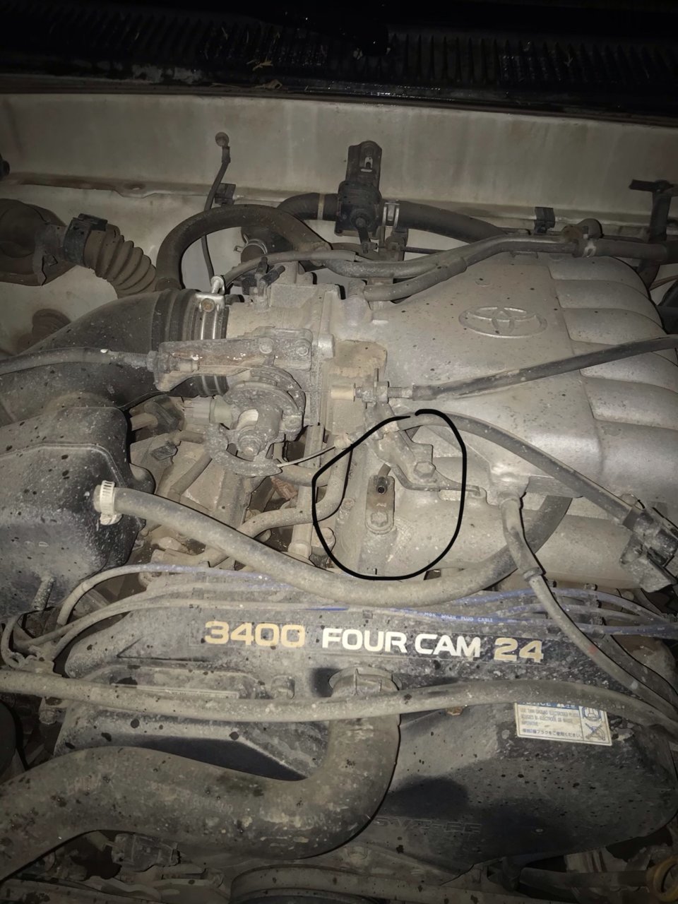

    No vacuume leak that one on my 4 runner goes to the airbox

    Not the half moons, the valve cover bolt grommet/washer things. 2 tubes of FIPG came in today so the half moons will get that. As long as I don't break one like I did on the Taco. The 4runner has 4 at the back, 2 per head.

    Oh the washer seal things

    Pre slice the rtv, peel in a direction, slice more while peeled back. Continue until they come off and clean surfaces afterward. That keeps you from wrenching them into pieces.

    More specifically, that is the by-pass if the fuel regulator fails. That line by itself will not cause a vacuum leak. The hose that attaches to it goes to the air tube between the air box and the TB. Should be down near the MAF. That also wouldn't cause a vacuum leak since it's only drawing unfiltered air into the engine.
    I know this because my fuel pressure regulator diaphragm failed after doing the valve covers and sitting without fuel for so long. The fuel was coming from the regulator, thru that tube and into the airbox as it's designed to do. In normal operation, there might be a slight vacuum on the diaphragm in the regulator from that.

    Yeah, I'm going to try digging more of the silicone out before ganking at then this time. And not try wiggling them front to back either. I broke the lip on one in the Taco that way.
