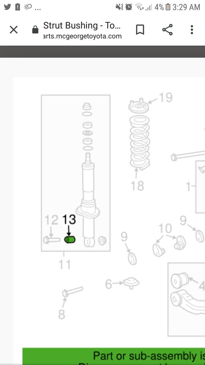

    90389-14048
    I wonder how long a new one of them would last
