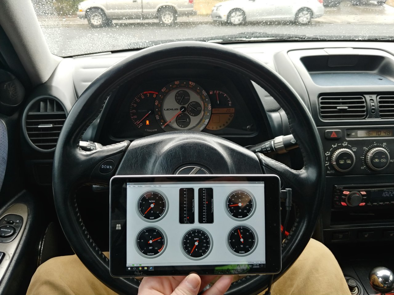

    It's less Tacoma and more mod
    I like this software and a little $30 windows Tablet makes it pretty easy to mess with
  16. Mar 29, 2020 at 10:53 AM
    Empty_Lord
    Empty_Lord Toyotaholic
    Mar 13, 2016
    #181186
    28,288
    Dan
    Northwest Indiana/Chicagoland
    What software?
  17. Mar 29, 2020 at 10:55 AM
    Speedytech7
    Feb 20, 2014
    #123587
    57,689
    FCQM+VG Cheney, Washington
    OBD Auto Dr. One of the only cheaper software packages I've seen with bi-di and mode $06 with populated names for manufacturer specific shit
    Empty_Lord[QUOTED] likes this.
