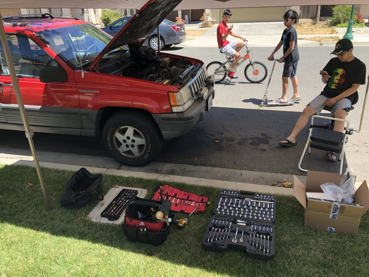

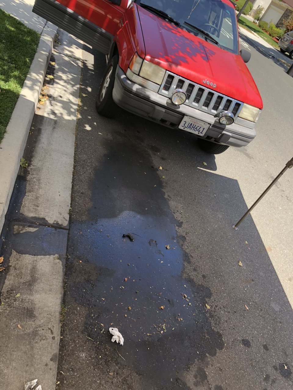

    I just finished changing out the Power Steering Pump on my buddy’s 1994 Jeep Grand Cherokee with the ancient 4.0l Inline 6. Steering was trash and all the fluid sprayed all over the engine bay.

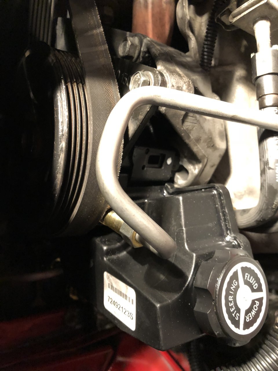

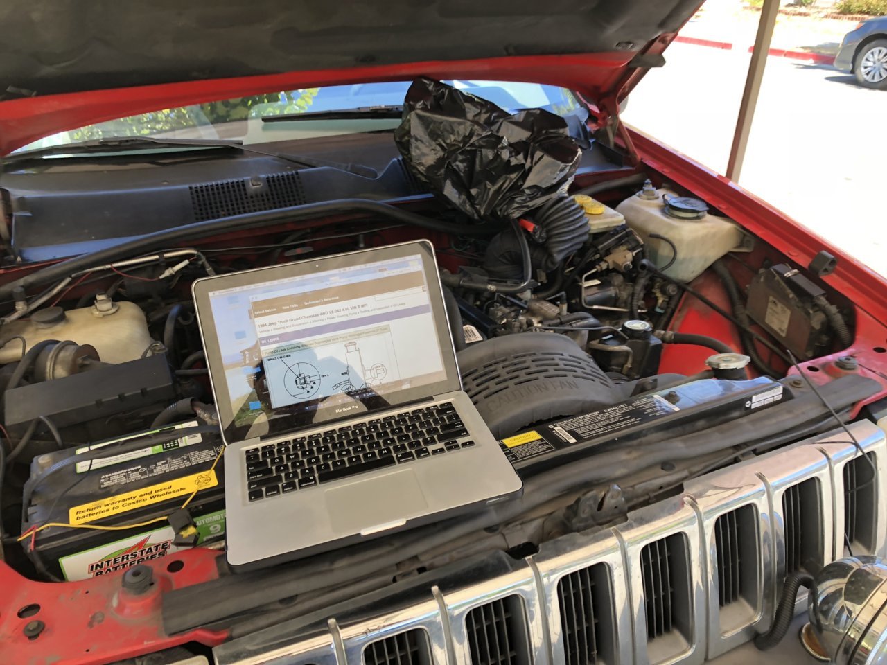

    After consulting AllData, changing the high pressure and low pressure lines would cost $95 and $26 respectively from the dealer. The Power Steering pump would be $450 for a dealer rebuilt one. AllData says it will take 3 hours of labor.

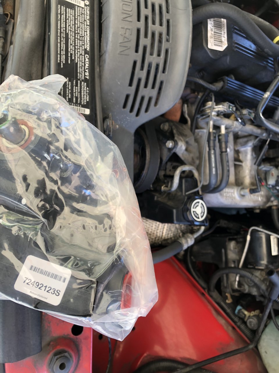

    Total cost spent from RockAuto and WalMart for the pump, lines, and two bottles of Power Steering Fluid was $140 and a day and half of my time. The RockAuto pump was even remanufactured for GM according to the certificate.
    Crazy how much money you save doing repairs yourself.
    Changing the pulley is a pain in the absolute ass. There’s no way in hell you’re doing it without a really decent air impact gun. I actually messed up the first day and did not push the pulley onto the shaft far enough, so I had to come back today and re-do it. As soon as you’d start the engine, the belt would slide off. Don’t get me started on the stupid belt tensioner mechanism built into the pump.
    Steering was dramatically different with the new pump. My buddy who drives it was shocked how well it steered. Shit it steers easier than my truck.
    New Pump & Lines Installed
    Oh and yes, this thing likes to leak.
    These are fun little trucks. Solid Dana axles, and AWD w/ 4LO on the Grand Cherokee. When this thing shits the bed I’m totally buying it and putting my E320 body on it.
