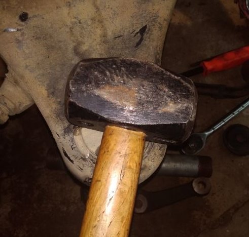

  17. Mar 30, 2020 at 4:40 PM
    CS_AR
    CS_AR Well-Known Member
    Apr 3, 2019
    #289019
    12,803
    1999 Tacoma PreRunner TRD
    Everything but the driveshaft. B03A - 410
    @cruiserguy and @Empty_Lord

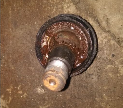

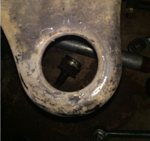

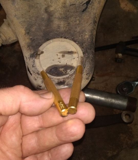

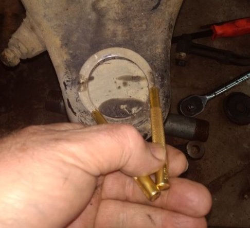

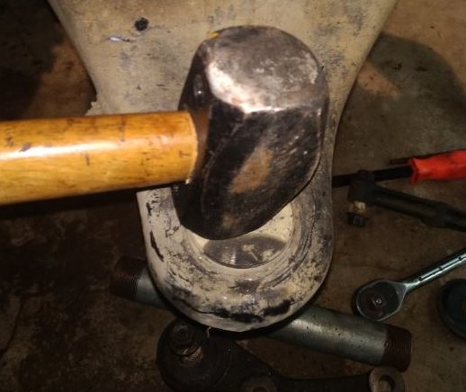

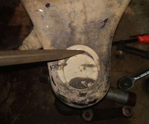

    Since I can't find any instructions for removing a lower ball joint (LBJ) on a 100 series Land Cruiser (LC100) or LX470, I decided to make some pictures. I managed to remove these in roughly 5 minutes per side.
    Step 1 - Use two punches of the same length for releasing the horseshoe c-clip. Hold the punches together and steady while you strike them with a 2lb hammer.
    Step 2 - Strike the punches with a suitable tool.
    Step 3 - Stop when you break the c-clip loose from the LBJ.
    Step 4 - Use a large screwdriver to finish removing the c-clip.
    Step 5 - Use a suitable tool to strike the base of the lower control arm and on top of the LBJ. Three good smacks did it.
    Step 6 - Watch the LBJ fly out of the lower control arm and land on the garage floor.
    Step 7 - Inspect the worn out LBJ to be glad you took the time to replace it.
    Now what do I do with these heavily worn control arms?
    Tags: LC100 LX470 Land Cruiser 100 Series lower ball joint LBJ c-clip removal instructions

  20. Mar 30, 2020 at 4:51 PM
    cruiserguy
    cruiserguy Well-Known Member
    Jul 31, 2016
    #193416
    19,000
    Elijah
    SEKS
    2000 ext cab, 2.7L, auto, 4x4
    I don't remember it being near that easy when I did the first 100 series lower bjs.... But hopefully it will be when I do the current 100 series lowers. Kinda cool about the dual punch and hitting em together at same time so that it'll actually work:D:cool:should add that to the FSM.... Gotta be easier than whatever way I did it before..... Maybe that's what gave me such a hard time? I truly don't remember. Maybe it wasn't that hard of a repair after all and I'm just being a sissy
    Anyways, are you replacing the arms then? Or just the bushings?
