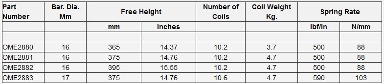

    Do you remember how the Oem spring ratings work? Too lazy to go search right now

    You've got 500lb springs and still too stiff with an ARB bumper? o_O
    (Thought 882s were 550lb)?

    I’m guessing I want 882’s then, not gonna have much weight up there

    All I plan is a hidden winch/ mount, think I need different coils? I’d prefer to stay around 2” of lift

    I run E tires as well with more air than others would and I don't think the ride is harsh.
    It's just that, I've got 600lb springs and yes without my ARB the front was stiff. But I only noticed it while off roading. @eon_blue remember when the front end of my truck wouldn't even travel much, even without a sway bar?
    That was the effect of 600lb springs with a stock front end and no diff (2wd).
    Now I run an ARB and the front is much more susceptible to flexing...and that's still without a diff or winch.
    So to hear your front end is stiff is odd as hell.
    Too much preload?

    My ARB alone would be the equivalent of a winch with hidden mount and front diff...I'd say 600lb should be fine unless they've got something in between like 580?
    I've got 2" of lift.
