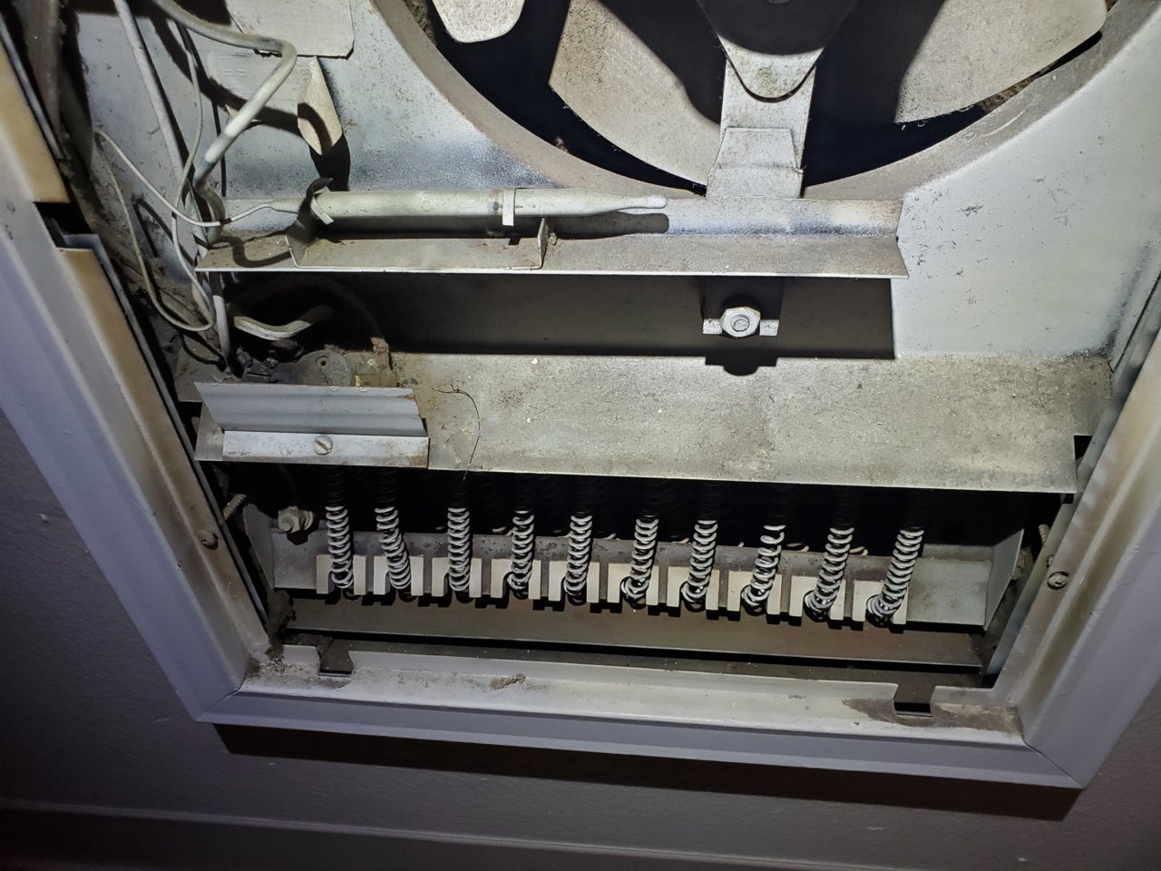

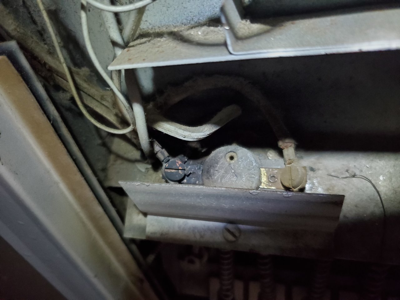

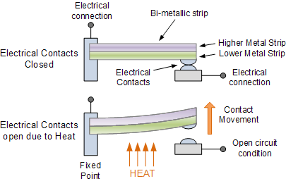

    Having tapped on this component (black circle) seems to turn on the heating element but won't do so on its own. What sends a signal for this component to turn the heating element on?

    That's a thermal switch.

    So I'm right to assume that's a live wire on the left and ground on the right

    no it's just a contact straight thru that opens or closes at a set temperature

    Should have temp stamped on back of it.

    Ok.
    Has nothing to do with the probe in front then?
    I ask because that thermal switch only has 2 wires that lead up to the control knob.
    When I turn the knob to turn the heater on, the element doesn't come on but the fan does.

    That switch opens if the heating elements get to hot. Like no air flow over elements. It interrupts the power to them until it cools down.

    Seems it's just stuck open, and needs disassembly for cleaning (contacts all dirty) or simply replacing if it's a cheap item to replace.

    replace. You need to know the temp for it. See if you can read the markings on the back. It's not a serviceable item. It's all crimped together.
