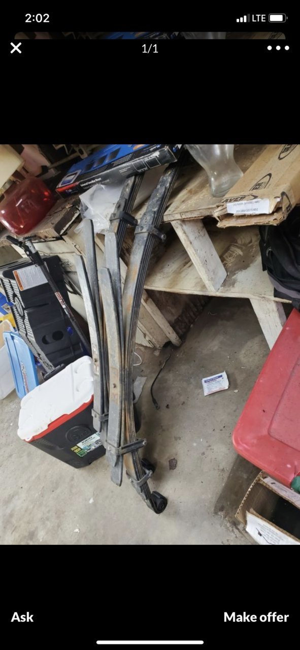

    do these look too rusty? trying to figure out if they'd be worth it to go check out, OME Dakars HD by the way

    4 run, 2 don't
    No such thing as an HD pack for 1st gens.
    They're just OME Dakars with one variation going on 95.5 to 97 and 98 to 04 (different lengths)
    Only other thing available is an AAL which that does not have; I'm counting 5 before the overload.
    They're affordable enough that I wouldn't buy them used, though if they're like 50-100 I would give them a shot.

    no, those look fine for a used leaf pack

    yeah sorry a little misleading, i meant they had all the leaf springs not the 3rd from the top missing

    Well there is an HD pack and non HD pack for later generations, just as long as you're aware.
    The rust isn't really an issue as they get banged up and scratched anyway during shipping anyway so that exposed metal will surface rust anyway.

    Nothing a can of rustoeluem can't fix for $6

    Also, if you do get them, do yourself a favor and get yourself the poly bushing that Wheeler's offers for the front eyelet.
    The factory one is pressed in, but easy to remove with a little bit of determination. This is the source for most all squeaking Dakar leaf packs.
