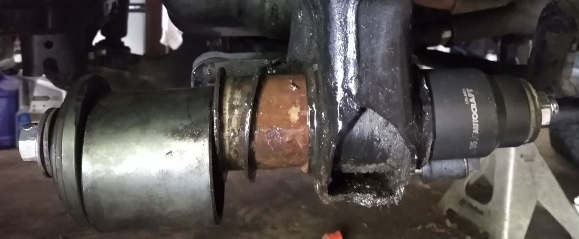

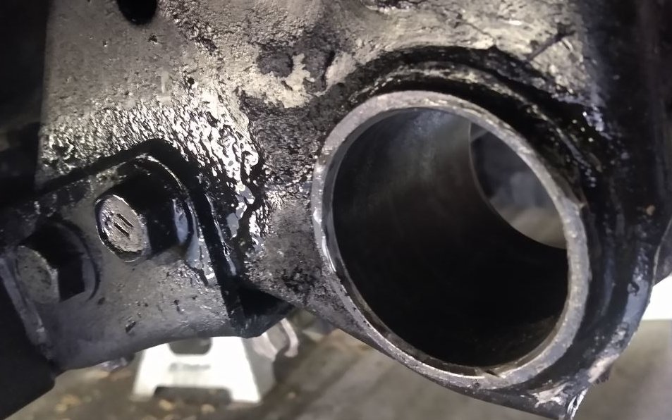

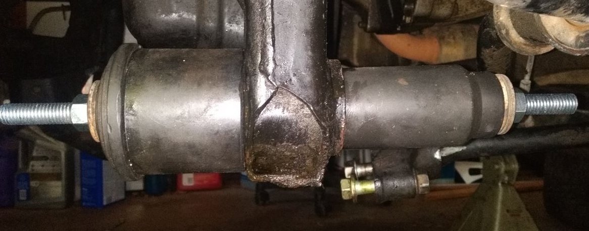

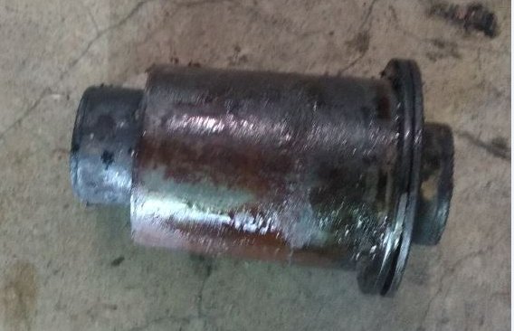

    @cruiserguy @Empty_Lord Pressed out the rear LCA bushing on the 100 series this morning. It can be done at home.
    The old bushing wasn't that bad, but since I'm replacing everything with this mid-life refresh, I wanted to go all the way.
    The grade 5 1/2 by 12" rod was just a little bit too light for the job. It would have gone better with a grade 8 or above. It took two rods to get through everything.
    I can see where I need to some cleaning before I put it all back together. Though this is not going to turn into a Bro rig so it will be getting into the mud.
    I borrowed the receiver side from Advance Auto in their big 4x4 ball joint press kit.
    I should have used a 34mm socket instead of 35mm. I got the socket stuck in the mount. I'll try a 34mm on the other side.

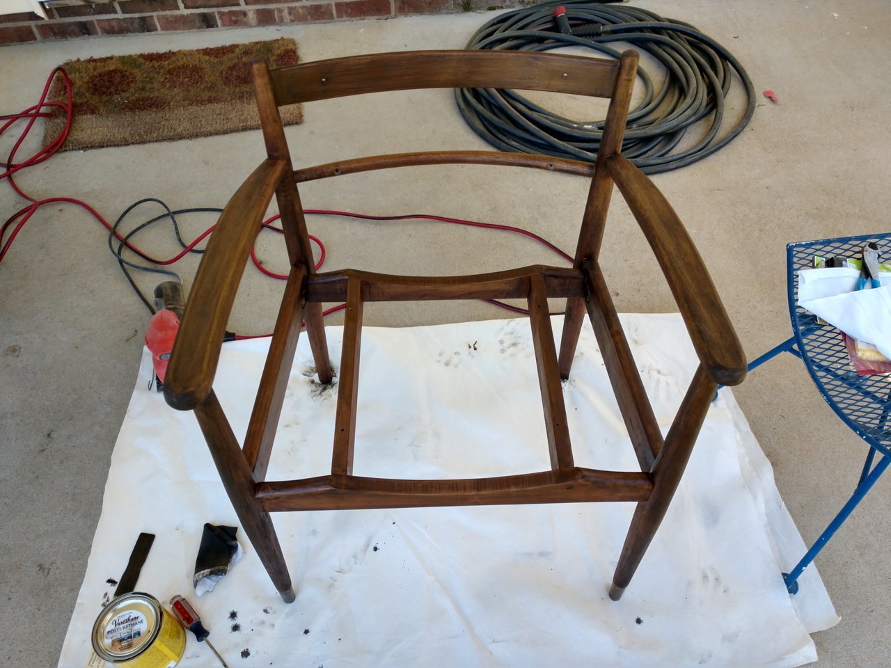

    Sanded and stained.
