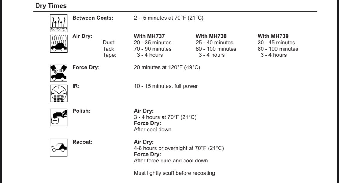

    Yeah. I don’t need one, but I have it so it makes my life easier. Stop trying to use California as a scapegoat. This is the same paint you can buy in any other state.
    See where it says 15 minutes under IR light instead of 3-4 hours?

    Did you wipe the paint down with acetone before clearing it?

    That's a terrible idea. It will dissolve the paint. You use 70% Isopropyl, followed by a tack rag.
