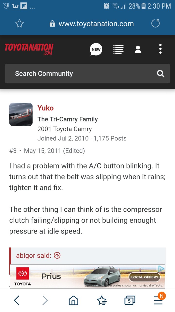

    Okay so the blinking light is it signaling that the pressure is low. Refrigerant low or belt slips or compressor wearing out internally
