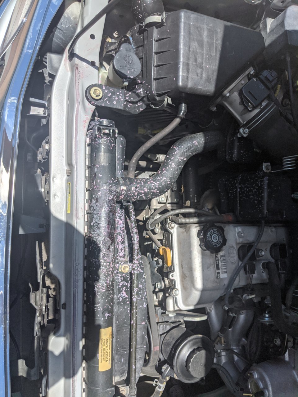

    What's going on here? Coolant?

    Im assuming so but cant cant where it came from. Greasy red sweet smelling coolant

    rad tank or hose leak and engine fan is blowing it around

    Yeah the Toyota coolant is like, Zerex? Red. It looks a little pink though, hope that’s not like coolant and oil milkshake. It should be a Gatorade cherry looking red.

    04 started using the pink. Pentofrost A4 is a suitable aftermarket replacement.

    Yes bright red. Will be checking my hose connections n stuff tn. Thanks wulf

    red coolant looks chalky and pink like that after the water evaporates out

    Hoping just a hose. If its its tank do i need to completely replace? Saw the sticker on the side and its original

    a radiator shop can replace the plastic tank cover but it might be worth doing the whole radiator. The parts places might have a coolant system pressurization kit you could use to help diagnose
