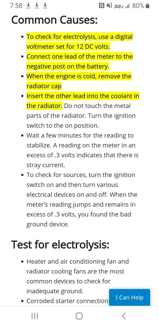

    If you have crappy grounds still and are worried you can do this test.. here's a link to the whole article if you'd like to read up on it ruining aluminum radiators.
    https://www.northernradiator.com/kn...electrolysis, use,the coolant in the radiator.
