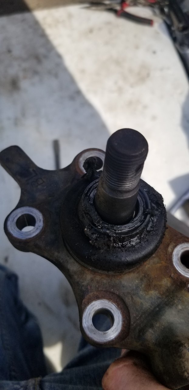

    I'm amazed the ball joint didn't seperate on me :eek:
    About to change the other side just for good measure.
    Please forgive me TW for I'm not using OEM joints :( I'm in a pinch and planned on doing all sterring components OEM when I bought and upgraded the suspension later this year
    Thankfully I won't have more than 10k miles on these off brand ones

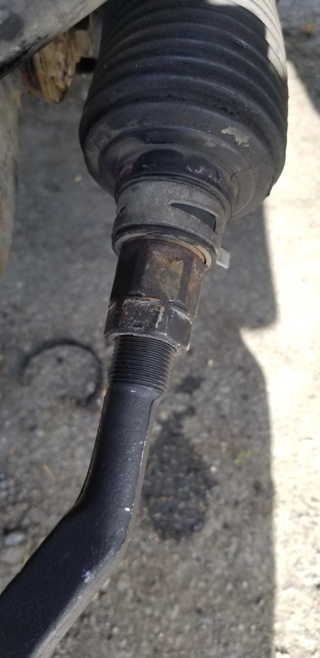

    Oh yea. Just leave the nut on the tie rod and when it’s off put it in roughly the same spot as the original. Forgot these trucks were backwards from every other Toyota

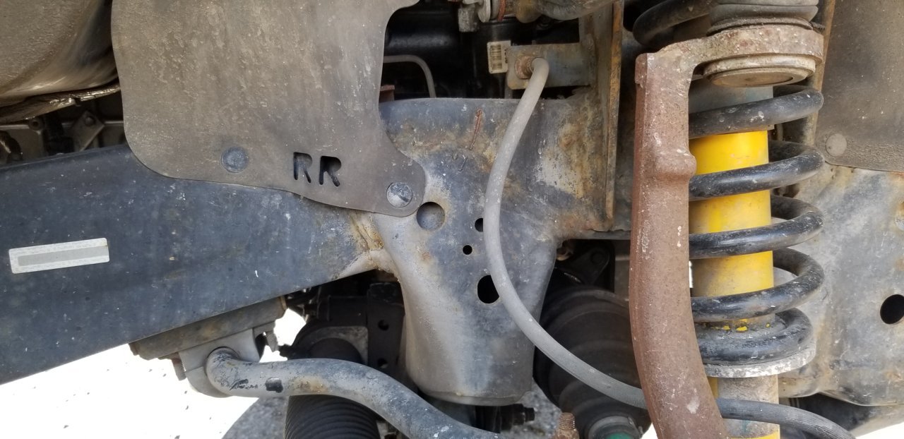

    I'll tell ya what.... I sure can get behind living in a salt free road state! This is the rustiest spot on my frame :D20200709_182121.jpg

    If that was a Californian's truck -
    "Rusted frame, need help fixing or parting out" :goingcrazy:

    My new OEM outer tie rods had less threads on them than the ones I took off so the thread count method didn't work out that great, but it was good enough to get me a few miles to the alignment shop. Not gonna be the end of the world as long as your tires aren't pointed into one another lol.

    What rust?
