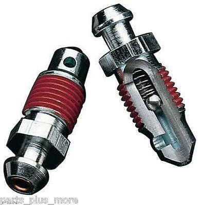

    Any of you guys ever bleed the abs pump on a 1st gen? Or know if it’s even possible/necessary? Have been needing to pump the brakes to stop lately and changed the master thinking that was the issue but problem is persisting. Running out of ideas.

    Getchu one man bleeders and do it yourself
    Ive stopped trusting others to bleed or help bleed my brakes

    There isnt a way to mess up one man bleeders
    Just crack open the bleeder and pump the brake pedal the one way valve in the bleeder prevents air from getting in

    Youre talking about to tool im talking about the screws

    I had those on a jeep, are you able to get those in metric sizes or is are the parts stores still in denial that vehicles are made in other countries than America (mexico and Canada in reality)?

    I have a pair on the Nissan calipers on my Jeep. Got em at Napa 10~ years ago
