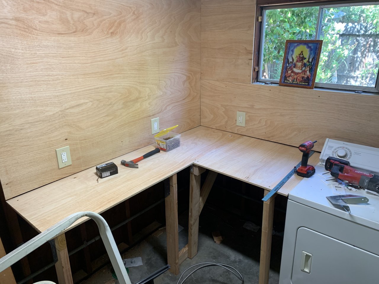

  7. Jul 14, 2020 at 5:22 PM
    Blue92
    Blue92 Well-Known Member

  8. Jul 14, 2020 at 5:22 PM
    what road

  9. Jul 14, 2020 at 5:23 PM
    Running Board Man
    Running Board Man Well-Known Member
    Feb 19, 2017
    #211024
    8,766
    You ever not had enough outlets?

  11. Jul 14, 2020 at 5:24 PM
    Sperrunner
    Sperrunner UA342
    Feb 23, 2018
    #245334
    50,264
    Miguel
    El Cerrito, Ca
    2023 Ford F250
    Its the company truck
    Its gunna be my workbench so i just over did it with outlets so i can have like my tool chargers and rc car charger and other stuff all setup at the same time if i wanted
  12. Jul 14, 2020 at 5:24 PM
    Blue92
    Aug 26, 2017
    #228071
    16,479
    Daniel
    North Carolina
    2018 Sport
    Only need one GFCI per wet location circuit. Adding more than one per circuit does nothing but cost you money.
    That is, unless @Sperrunner has them all on their own circuit.
    Speedytech7[OP] and Kwikvette like this.

  15. Jul 14, 2020 at 5:28 PM
    Sperrunner
    Sperrunner UA342
    Feb 23, 2018
    #245334
    50,264
    Miguel
    El Cerrito, Ca
    2023 Ford F250
    I bought a home depot pro pack so i have tons.
    there are like 3 “ Circuits“ in that room though its all on 1 breaker

  20. Jul 14, 2020 at 5:30 PM
    Blue92
    Aug 26, 2017
    #228071
    16,479
    Daniel
    North Carolina
    2018 Sport
    If you got em I guess its cool. As long as theres one GFCI on a breaker in a wet/damp location its up to code. Yours is just incredibly overkill haha.
